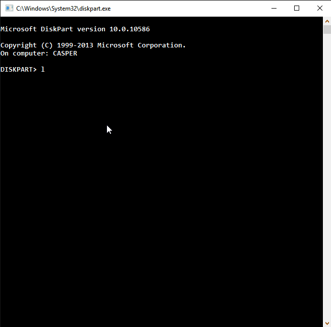

    2. From the opened Diskpart Command Prompt window, type list disk and hit Enter key.
    3. Locate the Disk # of your USB flash drive. You can easily find it by looking at the size column.
    4. Once you have the ID, type select disk # and hit Enter key. (Replace the # hash symbol with the actual USB flash drive assigned disk ID, such as 1).
    5. Type clean and hit Enter key to destroy any partitions, file system, and data that may currently be on the USB flash drive.
    6. Now it is time to create the partition. Type create partition primary and hit Enter key.
    7. For booting it is important to set the partition as active. Type active and hit Enter key.
    8. The file system must be FAT32. Type Format FS=Fat32 Label=Winboot quick and hit Enter key. This performs a quick format and labels the drive in one step. Windows will automatically mounts and assigns a drive letter to USB flash drive.
    9. Type exit to close the Diskpart utility. Your USB flash drive is now prepared for the next phase.

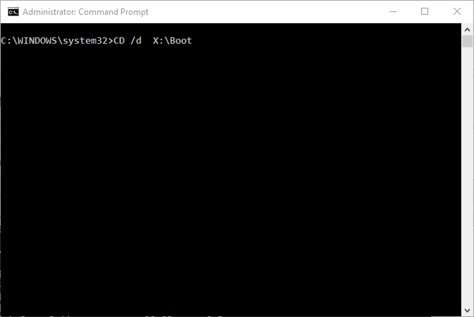

    3. At the elevated administrator Command Prompt change the Command Prompt directory path to the Boot folder that resides at the DVD media or mounted Windows Setup ISO image where bootsect.exe executable file lives.
    4. Type Cd /d X:\Boot, replace the X: drive letter with the DVD media or mounted Windows Setup ISO image drive letter.

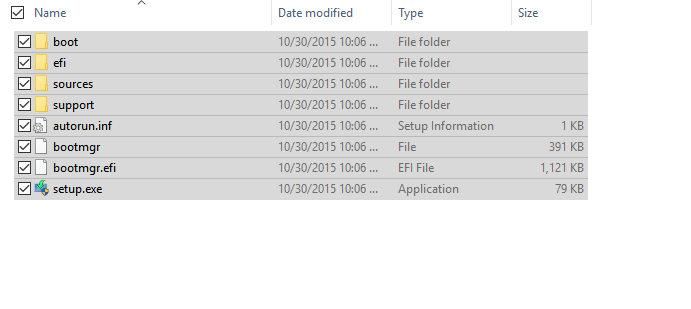

    The final step, now that you have your USB flash drive prepared, is to copy the Windows O/S setup files.
    1. Insert the DVD media into your PC or mount the Windows Setup ISO image and navigate to the drive on your computer that has the Windows O/S installation files.
    2. Select all the files, and then right-click and select Copy.
    3. Navigate to the root of the USB flash drive, right-click and click Paste.
    The file copy can take a number of minutes, but after it has finished you can install the Windows O/S quickly on machines with USB flash drive.
