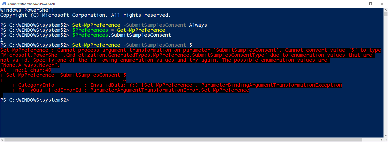

  3. How do I stop sending antivirus samples to Microsoft?
    Now, debating the reasons I don't want this happening goes beyond the scope of this post (actually asking for them probably goes beyond this post). This post is simply about how to stop sending antivirus samples to Microsoft.
    You might want to have a look at this Windows IT Pro Center document:
    Enable cloud-delivered protection in Windows Defender Antivirus - Windows security
    And also the documentation for:
    -SubmitSamplesConsent
    Specifies how Windows Defender checks for user consent for certain samples. If consent has previously been granted, Windows Defender submits the samples. Otherwise, if the
    MAPSReporting parameter does not have a value of Disabled, Windows Defender prompts the user for consent. The acceptable values for this parameter are:
    • 0: Always prompt
    • 1: Send safe samples automatically
    • 2: Never send
    • 3: Send all samples automatically
    -MAPSReporting
    Specifies the type of membership in Microsoft Active Protection Service. Microsoft Active Protection Service is an online community that helps you choose how to respond to potential threats. The community also helps prevent
    the spread of new malicious software. The acceptable values for this parameter are:
    • 0: Disabled. Send no information to Microsoft. This is the default value.
    • 1: Basic membership. Send basic information to Microsoft about detected software, including where the software came from, the actions that you apply or that apply automatically, and whether the actions succeeded.
    • 2: Advanced membership. In addition to basic information, send more information to Microsoft about malicious software, spyware, and potentially unwanted software, including the location of the software, file names, how the
      software operates, and how it affects your computer.
    Set-MpPreference (defender)
    But note that if you specify a value of 3 for the -SubmitSamplesConsent parameter, it will be rejected by the PowerShell interpreter:
    Windows Security keeps prompting me to send steamnetworkingsockets.dll for sampling. 797a79c0-ac71-4b30-9024-7e2ba850fca0?upload=true.png
    The bug report for the issue is here; and I see that they’ve now corrected that reference to
    Set-MpPreference -SubmitSamplesConsent 3 in the document cited above (without any acknowledgement, of course), but they obviously still haven’t corrected the documentation for the Set-MpPreference cmdlet:
