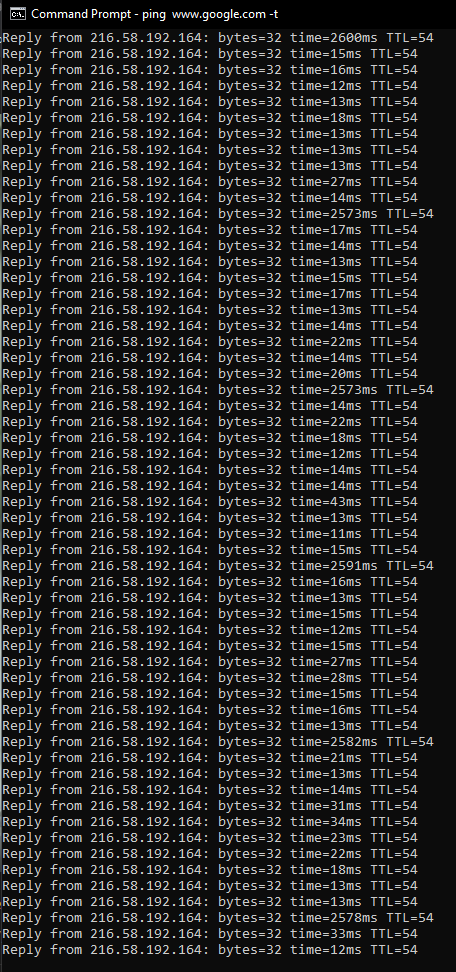

    Windows Scanning for Wi-Fi and causing ping spikes.
    I have been having a problem where my Wifi spikes every ten seconds. I have narrowed it down to the way Windows scans for Wifi every ten seconds. It is fixed when I disable WLAN Autoconfig but then when I restart my computer, it cannot find Wifi networks. This requires me to go back into the Services and turn WLAN Autoconfig on and off. This is not the most practical seeing that I turn my pc on every day. I would like to know if there is a setting in windows or a software that stops Windows from looking for WiFi once it is connected to a network. I don't need Windows to look for my neighbors WiFi every ten seconds when I am connected to mine.
    Windows Scanning for Wi-Fi and causing ping spikes. a7a4796a-853e-4a25-a6e3-4c9ea0868c81?upload=true.png
    Vogie4, Jan 27, 2020
