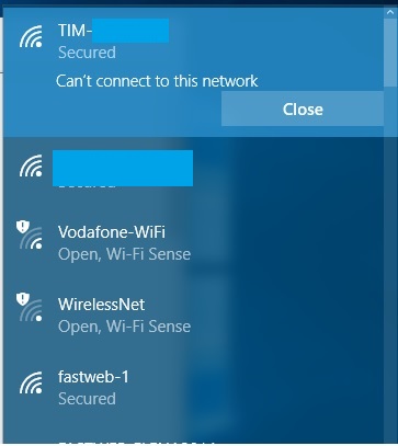

    Unable to connect to a specific Wi-Fi network in Windows 10
    I have been contacting Microsoft Support for the past 2 days to find a solution for this issue. But no one seems to know a fix. Hence I am forced to post this question, even though I know there have been similar posts earlier.
    I am unable to connect to a specific Wi-Fi network in my windows 10 pc. I am able to connect to that network with devices using other OS (like Android). I am able to connect to other Wi-Fi networks in my pc as well.
    Please note that I am unable to connect to this specific Wi-Fi network in my windows phone as well, which runs on Windows Phone 8.1.
    I have tried updating the adapter driver and used the windows troubleshoot. Both did not find any issue.
    Attaching below the screenshot of the error I see when trying to connect to the network.

    Update:
    I received a response from one of the Support executives with 3 suggestions, and none of them fixed the issue.
    Adding them here for reference.
    Method 1: Run network troubleshooter.
    Method 2: Configuring DNS server address:
    Network and Sharing Center --> Change Adapter Settings --> Click the Wi-Fi connection you want to configure.
    Could not proceed with this step as the specific Wifi network does not exist in the list
    Method 3: Try resetting TCP/IP and check if it works.
    On Command Prompt (admin) and Reboot the computer.
    netsh int ip reset c:\resetlog.txt
