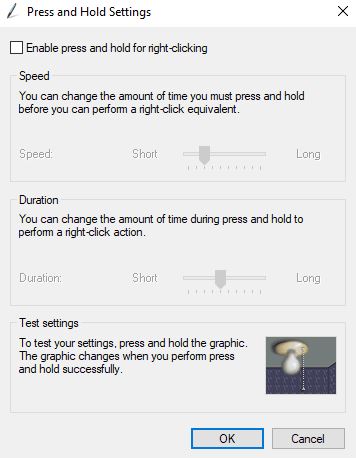

    Upon further investigating, I came across through a forum suggesting additional steps to somehow disable/minimize the appearance of the "Circle" icon. Kindly refer to the steps below:
    1. Launch Control Panel, change the View by to
    Small icons.
    2. Select Pen and Touch, select Press and hold and click on
    Settings button.
    3. This time, try to leave the box checked for Enable press and hold for right-clicking.
    4. Under Duration, move the slider all the way to the right.
    Although this method is not the perfect fix, this will somehow make the "Circle" icon only show up for the first time.

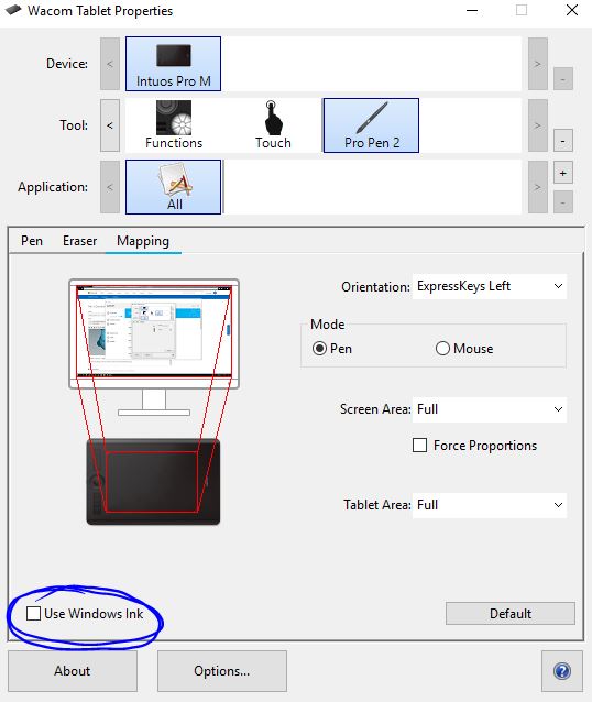

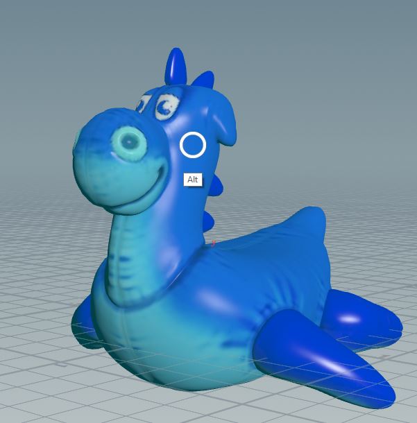

    As the subject mentions, I am trying to prevent Microsoft's ink & touch functionality from interfering with Wacom's pen and tablet. I use the Wacom Intuos Pro for my 3D work within applications like Photoshop, Zbrush, Houdini, Maya, etc... and whenever
    I try alt + right clicking with my pen, this is the result that I get:
    Windows Ink & Touch - Disabling "Circle" icon when Right Clicking with pen on surface book 2 1b206440-ef0d-47be-8356-9a1c87626745?upload=true.jpg
    Essentially, the windows ink circle thing pops up, and I cannot alt + right click because of it defaulting to alt + left click instead.
    I've tried many things to remove windows ink and touch functionalities including...
    1. Updating all Wacom drivers & firmware to the latest and turning off "Use Windows Ink" in the tablet settings...

    2. Configuring the "main" pen and tablet settings like so:
    3. Going through the "other" windows pen and tablet settings via the control panel (which is now also missing the "flicks" tab btw)
    Windows Ink & Touch - Disabling "Circle" icon when Right Clicking with pen on surface book 2 81512f85-6319-4337-bfa8-e5b7790e6afd?upload=true.jpg

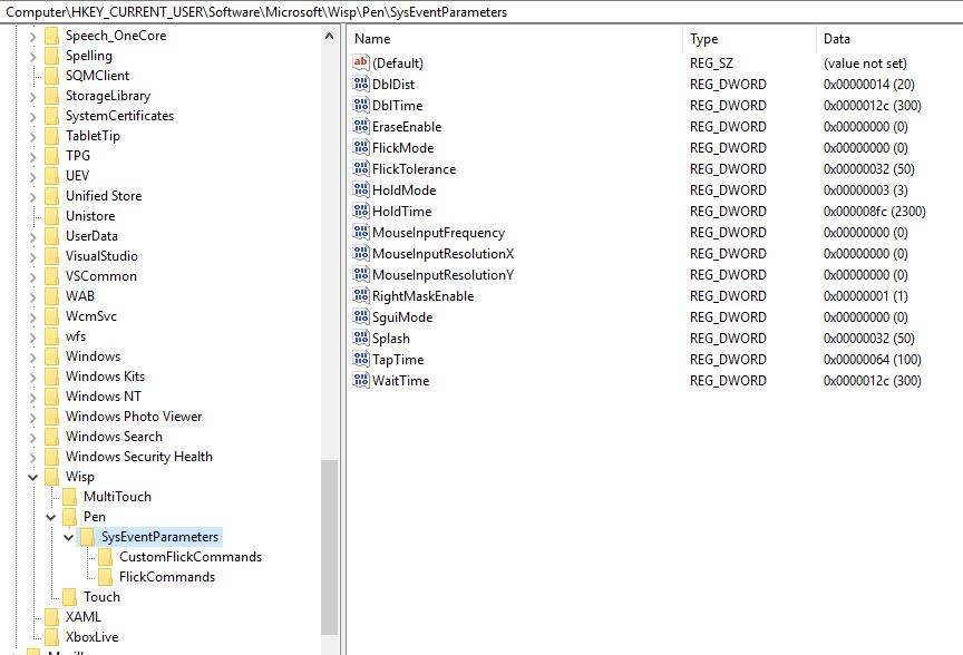

    And finally, configuring the registry to disable "Hold mode," "Flick Mode," and "TouchMode_hold"
    Windows Ink & Touch - Disabling "Circle" icon when Right Clicking with pen on surface book 2 a85c140c-6ad9-4efd-a726-258bf21bec1e?upload=true.jpg
    Sooo.. I dont know how to fix this. It's crucial to my work that I can alt + right-click things, and I strongly believe this is a Microsoft issue due to the fact that the "circle" icon which is popping up is nearly identical to the "press and hold" circles
