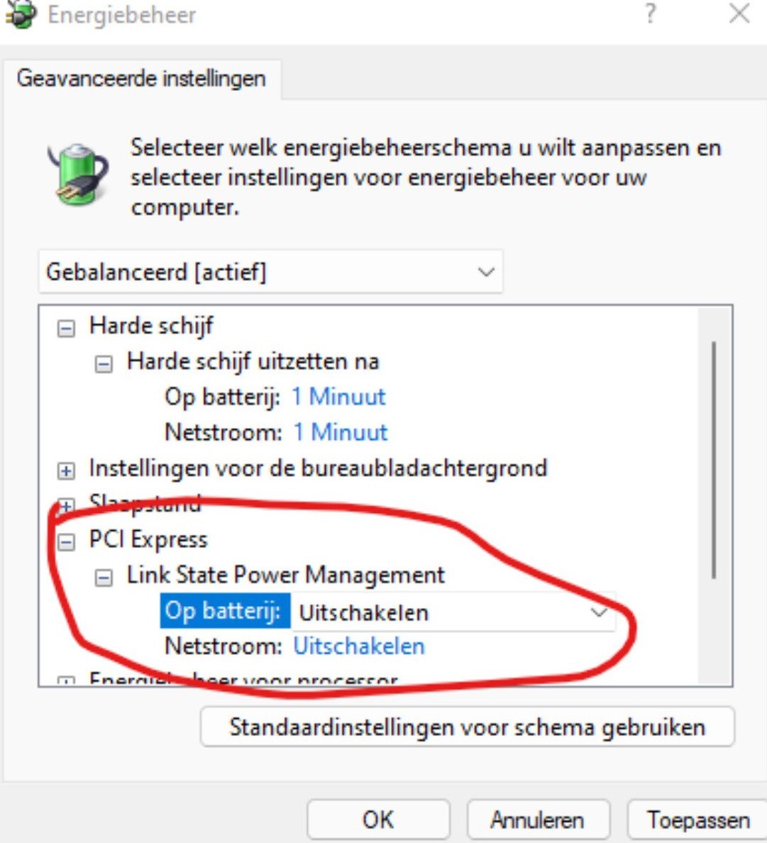

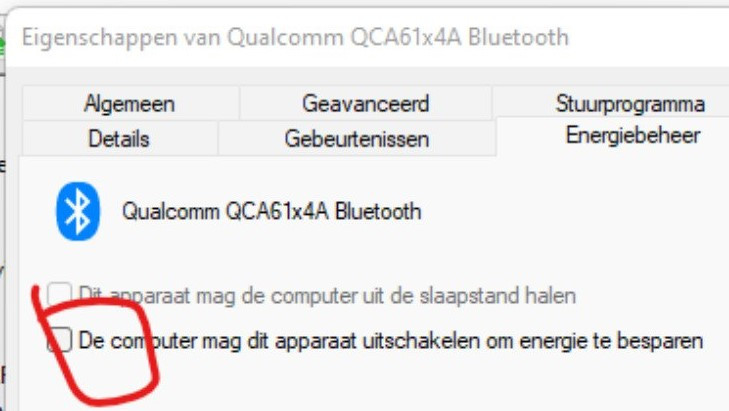

    What I did to try solve the problem:
    • Ran the troubleshooter of windows
    • Updated drivers
    • Renewed windows 11
    • Disallowed the wifi to be turned of to save power
    • Switched off link state power management
    Unfortunatly none of this did fix my problem. Any help?

    What i tried myself;
    updated drivers with the my dell app
    Enabled hibernate, using hibernate din't cause the issue, so i suspected sleep.
    Disabled power savings options of the wifi card in the device manager. Also switched off link state power management in energy management. Both to no avail.
    Then also switched off the activation timers in energy management.
    Also downloaded a radeon (my cpu and onboard graphics is from AMD) driver that did not appear to be in the xml driver list export off the dell update app.
    Lastly did the Refresh hiberfil.sys File off the Dell guide.
    Do not know what fixed it but I am now two days without a single crash in sleep mode.
    Good luck
