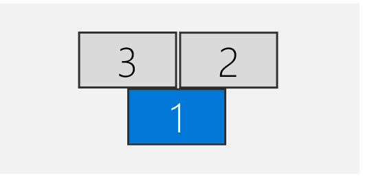

    Step 1: First things first: Check to make sure your Dual Monitors are setup correctly, If they are you'll see them in the Settings > Display, Similar to the image below.
    Step 2: Check your Display Settings for your monitors and see if you can get the monitors to touch, In the event that you can, the Snap feature shouldn't be a problem afterwards. If it is, your issue is something else. If there is a Gap between the monitors move to step 3.
    The Image below shows how Monitor 1 is clearly touching Monitor 3 & Monitor 2, This means that they will work fine without the snapping feature interfering, But Monitor 3 & Monitor 2 Have a small Gap between then, that means the snapping feature will Interfere and causing 'sticking'.

    Although i was not able to fine an OFFICAL Microsoft solution for this & I believe Microsoft should add a 2nd Feature in the Monitors page to allow Snapping between monitors/not Easy Toggle button, I did figure out how it currently works & a reasonable Workaround.
    Step 3: In the event that you have a GAP between the Monitors you may actually need to just swap between the screens Faster with the application. When I was trying to fix this personally I noticed that if I Drag the application slowly, The snap feature kicks in. But if i do it substantially faster then normalOr Increase Mouse Speed it works just fine without snapping & without a 3rd party Solution/Adjusting settings.
