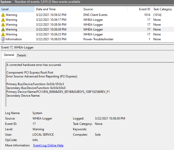

    Hello friends,
    I've had this problem for about a 1 week that I can not solve.
    My laptop started to disconnect from the wifi, there are days that it disconnects every 2 minutes, there are days that it takes a little longer. And it stays disconnected for about 20 seconds and then it comes back alone. The problem is clearly on my pc, since on the phone and on the other computer the connection remains stable.
    I started to notice in these 2 errors in the Event Viewer, that I think are related:
    WHEA-Logger 17 which happens very often
    Component: PCI Express Root Port
    Error Source: Advanced Error Reporting PCI Express
    Primary Bus: Device: Function: 0x0: 0x1D: 0x3
    Secondary Bus: Device: Function: 0x0: 0x0: 0x0
    Primary Device Name: PCI \ VEN_8086 & DEV_9D1B & SUBSYS_108F1025 & REV_F1
    Event 1014, DNS Client Events which always occurs just before realizing that the internet has crashed
    Name resolution for the name [always changes the site] timed out after none of the configured DNS servers responded.
    Whea_logger 17 error, wifi disconnects every 2 minutes 2838d576-b284-4310-b0b9-7ca3268f3297?upload=true.png
    2 days ago I even formatted the pc Windows 10 Home and updated all possible drivers and used Windows Update, but the problem persists.
    I already took these steps on cmd:
    sfc / scannow
    Dism / Online / Cleanup-Image / ScanHealth
    Dism / Online / Cleanup-Image / CheckHealth
    Dism / Online / Cleanup-Image / RestoreHealth
    What else can I do?
