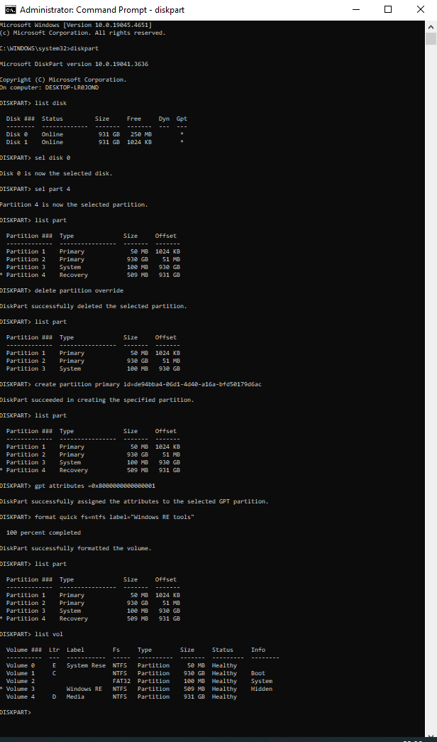

  3. Manually resize partition for KB5034441 not increasing recovery partition
    After encountering the KB5034441 update error I decided to use the following support article to increase the size of my windows recovery partition:
    KB5028997: Instructions to manually resize your partition to install the WinRE update
    I have followed the steps as described however my Recovery partition does not get any larger.
    I have:
    • disabled WinRE (not seen in the screenshot)
    • Shrunk the C drive partition (not seen in the screenshot but you can see the 250MB free space on the disk) in the first list disk call
    • deleted the previous Recovery partiton with 506MB
    • Created a new Recovery partition with attributes and formatted it
    But having completed all the steps my Recovery partition is still 506MB and the free space hasn't been reallocated so the update continues to fail.
    See my screenshot:
    What to do if update KB5042320 fails after I resized my RE partition? 8l7wnkQD6pz6JZFN4KPz9LXkwMkC%2BqMsAAldZhb7%2BzKZTsa90hi3PcbAcnEqUaeGstD1OHkEhENTjRPtd9LklOh5c%3D.png
    I saw in a (timestamp 4:11) that if the C drive partition is not next to the Recovery partition then there are extra things that need to be done but I do not understand them.
    Can someone help guide me through?
    PS I don't actually know what the purpose of partition 3 is. In disk management it is called EFI System Partition so I assume it is necessary and I have worked around it.
    CDR Asmodeus, Nov 3, 2024
