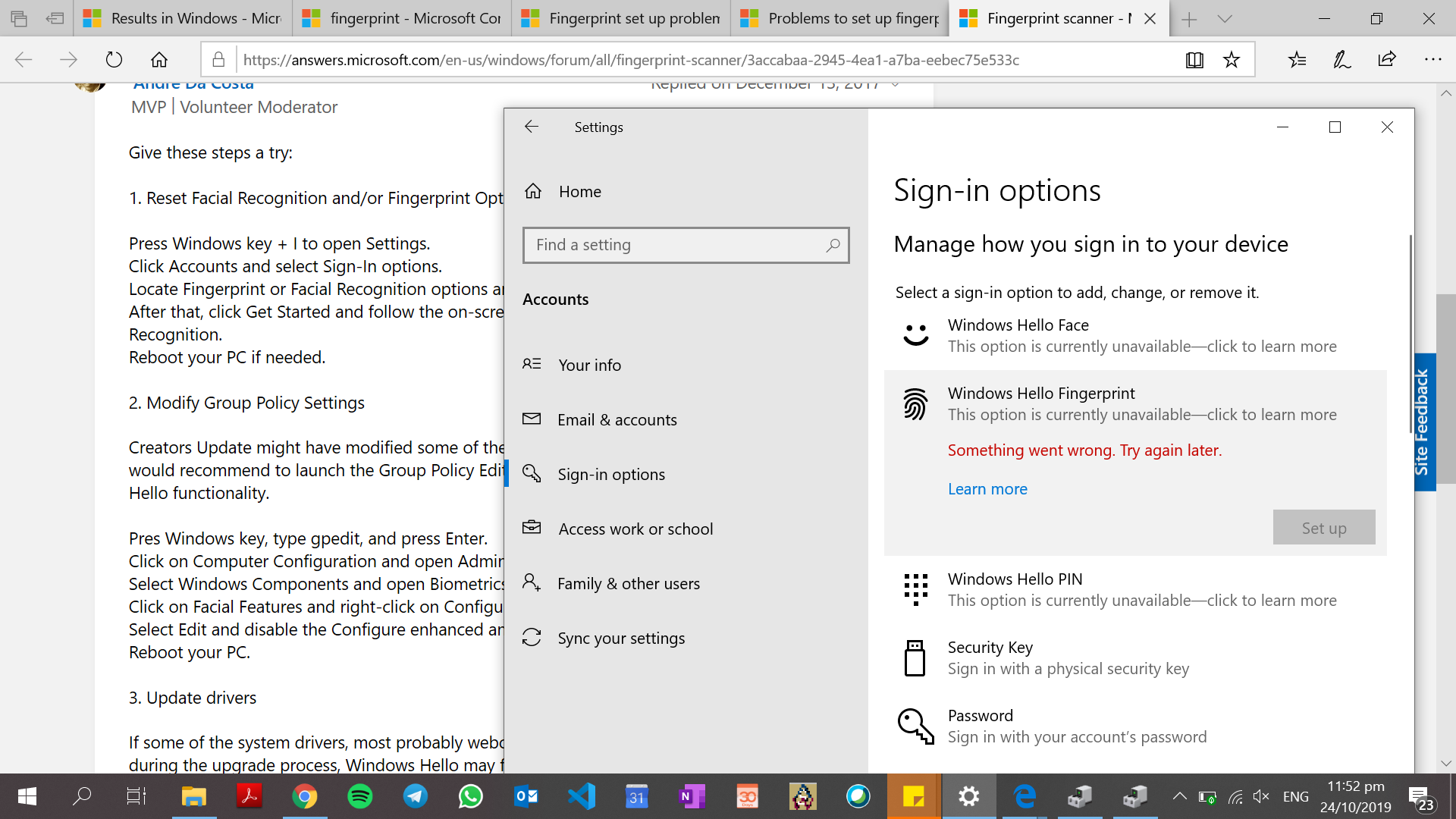

    Hi, as seen from the picture it says that windows hello fingerprint is unavailable and I am currently using a Lenovo thinkpad x1 carbon 7th gen.
    Any idea how to fix this problem?

    We understand that you are unable to use Windows Hello Fingerprint to sign in to Windows. It would be great if you can reply with the details requested below:
    • When you say, “I am not getting the option to log-in into windows using fingerprint.” What login options do you see on the login screen?
    • What happens when you try to use the Windows Hello Fingerprint scanner to login to Windows?
    • Were you able to use the Windows Hello Fingerprint to login to Windows earlier?
    Ideally, on the login screen, you will see Sign-in options that allows you to use different sign-in methods to login to Windows.

    If the issue persists, try removing the Fingerprint and add it again. Refer the steps mentioned below:
    1. Press Windows key + I, to open
      Settings
    2. Click on Accounts and click on
      Sign-in options
      on the left pane.
    3. Now, click on Windows Hello Fingerprint and click on
      Remove.
    4. Follow the on-screen instructions to remove the Fingerprint.
    5. Once done, click on Set up and follow the on-screen instructions to add the Fingerprint.
    Let us know how it goes.

    Yesterday I had a chat discussion with one of the Microsoft tech agents. After much troubleshooting and hit and try, some issues got fixed.
    I use HP Client Security for fingerprint login. There I also created 'spare key' which was preventing Windows to show fingerprint login option. When I removed spare key option, I got back the fingerprint login option for me.
