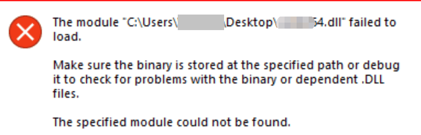

    unable to register the dll/ocx regsvr32 failed with exit code 0x5 ArZsWwFqq6RhZeks4IddZw56EElIu5HF%2frkRIt2kYen1Hjr4EZul8A%2fLcD8mYKejYcQ8eEBHDgjlKGWQ9iQ5nbhIc%3d.png
    The error can be because you are trying to register a 32-bit DLL or OCX file through 64-bit Regsvr32. You need to use the 32-bit Regsvr32 that is located in the Syswow64 folder. You can type the following command to register 32-bit DLL or OCX in a 64-bit operating system.
    %SystemRoot%\SysWOW64\regsvr32 <filename>
    If there are any dependencies (other DLLs or OCXs) required by the file you're registering, make sure they are present in the same directory or already registered.
