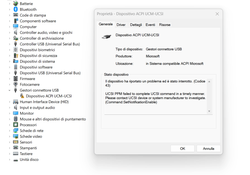

  3. UCM-UCSI ACPI Device driver error
    Hello, I have some problems with my HP 846 G9 laptop with Windows 11 22h2. My USB-TYPE C ports have problems.
    For the UCM-UCSI ACPI Device, it reports an error that "Windows has stopped this device because it has reported problems. (Code 43)".
    UCSI PPM failed to complete the UCSI command promptly. Please contact the UCSI device or system manufacturer to investigate.
    (Command: SetNotificationEnable)
    When I try to plug in a USB HUB with an HDMI port and try to use an external monitor connected to the HUB, no connection is reported and no image appears probably due to the UCM-UCSI ACPI Device driver error.
    CARLIZZI Gaetano, Apr 9, 2025
  4. UCM-UCSI ACPI Device driver error
    I try to reply to you answer, I think doesn't apply to my case:
    - In similar cases in some forums in other languages, it can be related to BIOS cache errors and may require a reset to release BIOS data.
    My HP has an AMD cpu, not Intel.
    BIOS is up to date.
    Similar PC with Windows 10 works perfectly.. I think is a problem with Windows 11. All PCs in my company running windows 11 have the same issue.
