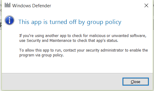

  3. ankitZC Win User
    This app is turned off by group policy.
    hey,
    some apps were installed on my laptop automatically and after that windows defender is turned off.
    it says "this app is turned off by group policy"
    it happened twice, first time i delete the registry value from registry editor,and it worked.
    But now i cant find a value.
    Turn on App & browser control via Group Policy or the registry 789828e6-5ca8-4670-ab6b-754edd54f677.png
    [Moved from Windows 10]
    ankitZC, Oct 25, 2022
