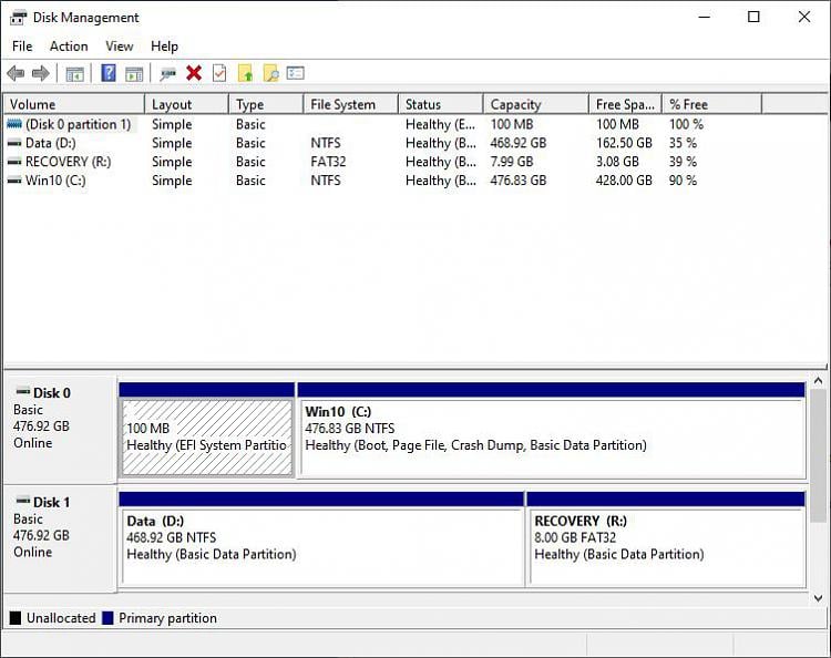

    There are 4 partitions on the disk. After the EFI system partition the is a tiny Microsoft System Reserved (MSR) partition that will not show up in disk management. It will if you list partition in diskpart:
    Trojan located to the recovery partition 278056d1589070181t-windows-has-wrong-location-recovery-partition-capture.jpg

  3. Failure to apply update due to recovery partition issue?
    My suggestion would be to:
    1) Disable WinRE
    2) Delete partitions 4 and 5.
    3) Extend the C drive to utilize the unallocated space (minus 750 MB)
    4) Create a Recovery partition in that 750 MB unallocated space.
    Step 1:
    To disable WinRE, run:
    • reagentc /disable
    Next, check if winre.wim has been moved to the c:\windows\system32\Recovery folder. To do so, run:
    • dir c:\windows\system32\Recovery /a
    Please post the outputs.
    Ramesh Srinivasan, Apr 10, 2025
