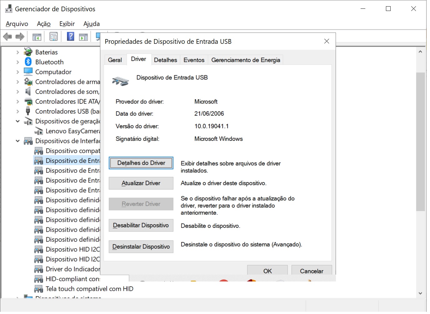

    Hi all.
    Need some help here regarding my touchpad. I have a Lenovo Yoga 3 11 laptop, and the touchpad buttons simply don`t work at all with windows 10.
    I tried to update the driver from "hid microsoft driver 10.0.19041.1" to "Synaptics 19.0.13.0" available on Lenovo support website,but it doesn`t work at all, and still the microsoft driver is shown at device manager. sorry, system language is PT-BR.
    I am available to try anything you tell me.

    I had similar issues too but I now have my Yoga 3 11 working fine. Sorry its not that simple but this is roughly the procedure I went through:
    • I did a full reset of Windows 10 (Settings > Update & Security > Recovery > Restart now (in advanced startup) > Troubleshoot > Reset this PC > Remove everything).
      YOU MUST BACKUP EVERYTHING and save all your settings and bookmarks etc as this will remove everything from your computer. You will need to reinstall any apps and programs afterwards. This cleared up a lot of the glitches that occurred after
      the upgrade and helped a lot on all of my Windows 10 machines and although it takes a few hours it is well worth the effort.
    • After resetting install all Windows 10 drivers for the Lenovo 1170 (which is the Yoga 3 11) at the Lenovo driver website
      http://support.lenovo.com/au/en/products/laptops-and-netbooks/yoga-series/yoga-3-1170
      . The most important one which fixes the screen rotation problem is the ITE sensor firmware update but the other one is the touchpad driver which fixes the soft keyboard
      issues. You should also install the firmware update (which is for Windows 8.1 64 bit but installs in Windows 10) as well as Harmony which also says it is for Windows 8.1 but installs in Windows 10. Harmony made my system automatically switch between tablet
      mode and desktop mode. I suggest that you install all of the Windows 10 drivers and cross check against device manager to make sure that you are installing the right driver.
    • I also remember that I installed Lenovo settings through the app store and it went on to redirect me to the Lenovo website to install further required software. I can't remember if it 100% required but it does no harm so I would recommend it. It may need
      to be done before installing Harmony.
    After all this everything should work okay except I have noticed when it is in tablet mode when you start your computer you need to open the Yoga 3 11 into the laptop position to type your password or pin number as the soft keyboard displays quickly then
    disappears. Also some programs do not automatically bring up the keyboard so I recommend in tablet mode long pressing the tablet mode task bar and selecting "show touch keyboard button".
    I hope this helps.
