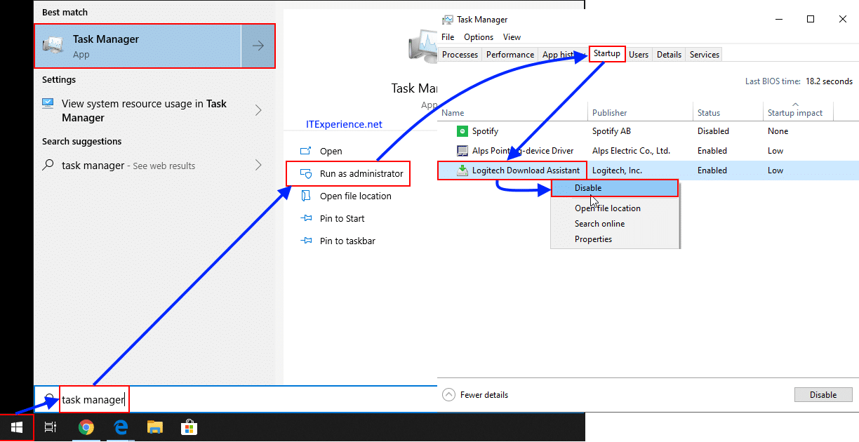

    2. Type Task Manager in the search bar
    3. Click Run as administrator
    4. Click tab Startup
    5. Right-click Logitech Download Assistant
    6. Click Disable
      Note: If any additional Logitech software is listed, you might want to disable them too.
    7. Restart your computer to make sure the error is gone
      There was a problem starting C:\Windows\System32\LogiLDA.dll The specified module could not... %2fwww.itexperience.net%2fwp-content%2fuploads%2f2018%2f12%2fdisable-logilda.dll-in-task-manager.png

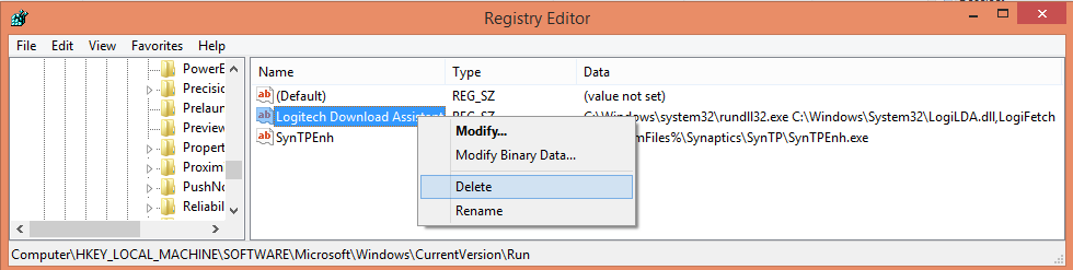

    Another option is to modify the registry. To delete the Logitech Download Assistant registry key, follow these steps:
    1. Open your Registry Editor as administrator
    2. Navigate to HKEY_LOCAL_MACHINE\SOFTWARE\Microsoft\Windows\CurrentVersion\Run
    3. Locate the key Logitech Download Assistant, right-click and click Delete
      There was a problem starting C:\Windows\System32\LogiLDA.dll The specified module could not... ext?url=https%3a%2f%2fwww.itexperience.net%2fwp-content%2fuploads%2f2013%2f12%2fimage_thumb4.png
