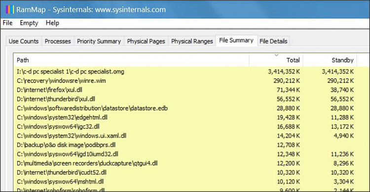

    Task manager not showing complete memory usage?
    This has a couple of angles on this topic:
    All Physical memory being used but nothing showing in task manager - Microsoft Community
    Note the comment about data loaded into RAM- not necessarily exe's or dlls.
    Suggest this view:
    Task Manager Memory Usage is Incorrect 62929d1485962888t-task-manager-not-showing-complete-memory-usage-snap-2016-02-07-15.19.38.jpg
    The top file is an O&O disk image file I've just created and written to an external USB.
    The second is part of creating OO DiskImage's bootable CD

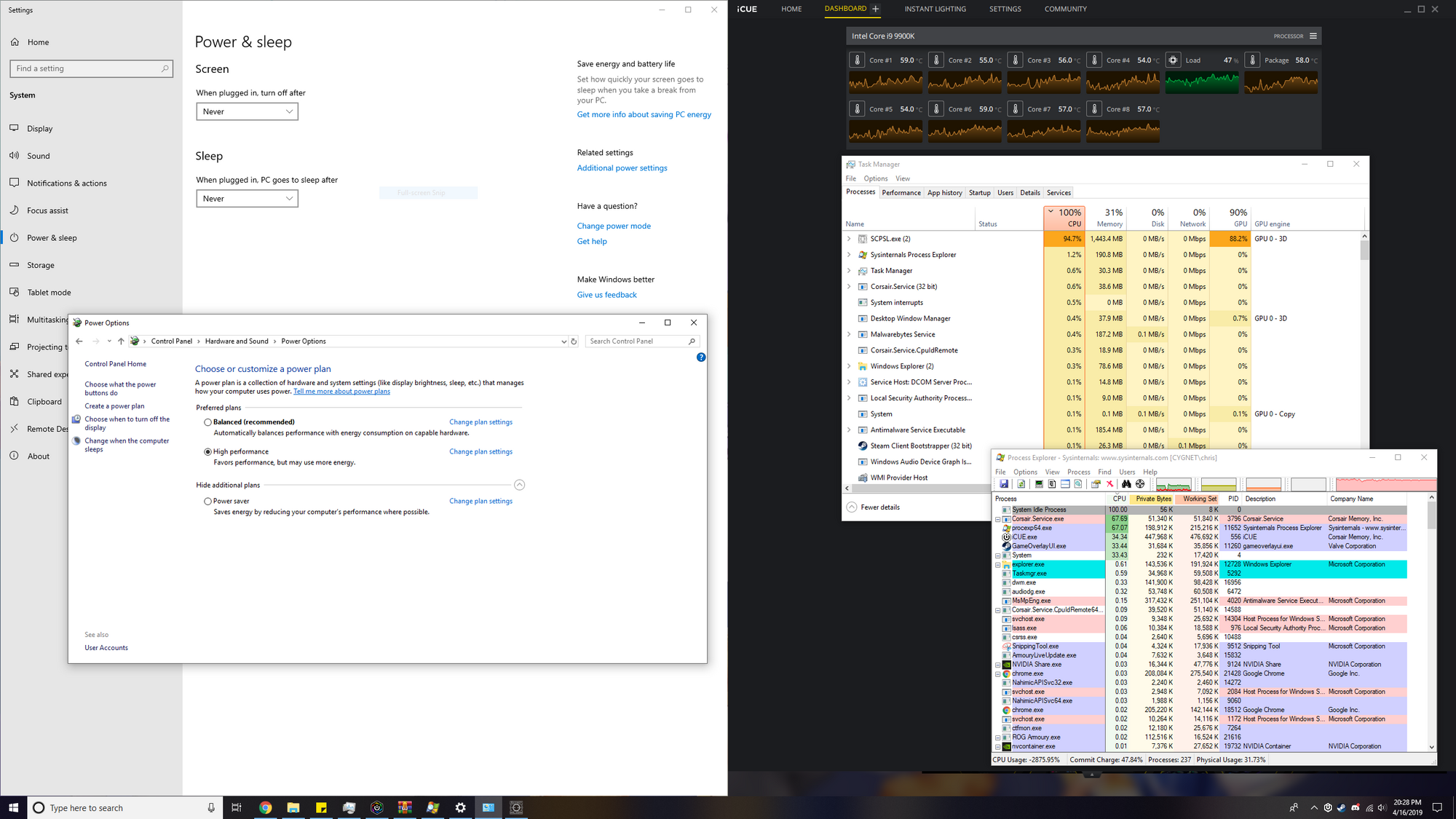

    Task Manager Incorrect CPU Usage
    So for roughly the past couple of weeks, I have been having issues with task manager giving me incorrect readings on the CPU usage. Before noticing this issue, I have been running my 9900K at 4.8 GHz all core with an AVX offset of 1. Initially, reducing
    my clock speed by 100 MHz down to 4.7 GHz all core (AVX offset 0) solved the problem for a couple of weeks, but the problem has now resurfaced despite the CPU literally running at specified stock speeds.
    The Task Manager program is incorrectly reporting CPU usage spiking up to 100% at times, sometimes accompanied by the display turning into a black screen for a half-second while playing SCP: Secret Laboratory. Meanwhile, other programs that were running
    at the time such as Google Chrome or DIscord turn into black windows and require restarting. Other programs such as HWiNFO64, Corsair iCUE, and Process Explorer are reporting much lower CPU usage percentages.
    Any ideas on what is causing Task Manager to behave like this? I thought Windows shipped out an update that fixed the broken Task Manager, but apparently not for me. I have already tried a clean installation of Windows 10 Pro to no avail.
    CPU: i9-9900K @ 4.7 GHz all core
    RAM: 4x8 GB @ 3200 MHz, XMP I
    Motherboard: Asus ROG Maximus XI Formula, BIOS - American Megatrends Inc. 0905, 4/10/2019
    Windows 10.0.17763 Pro Version 1809
    OS Build 17763.437
    Full Desktop Parts List: https://pcpartpicker.com/list/Cz87LJ
    Task Manager Memory Usage is Incorrect dd7c913e-4097-4f90-bc33-9ac5ca19c456?upload=true.png
    This was taken while running a game (SCP: Secret Laboratory, SCPSL.exe). Something seems off with the process explorer too since the game should be the highest in CPU usage, and the CPU use of the processes don't add up to 100%. I have seen this occur when
    the computer freezes for a half-second for no apparent reason.

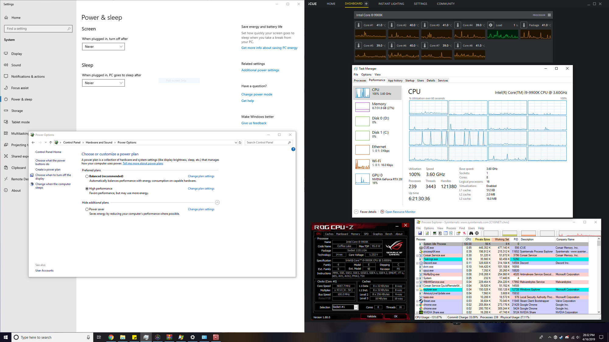

    Task Manager Memory Usage is Incorrect ac99c841-4fdf-4a38-8c7d-afc5e21c7069?upload=true.png
    This was also taken while running the same game mentioned above, except this time only the Task Manager is reporting an incorrect CPU usage while Process Explorer says otherwise.
    Task Manager Memory Usage is Incorrect 1e4191b2-105b-479f-88b6-4ec40d4b42ca?upload=true.png
    This image shows Task Manager claiming that the CPU frequency is being throttled to 3.6 GHz. CPU-Z is reporting a clock speed of about 4.7 GHz. Task Manager also seems to think CPUs #8 and #9 (starting from #0) are going crazy. I've checked both CPUs in
    HWiNFO64 and Process Explorer and found nothing wrong with them.
