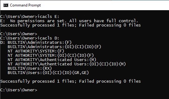

    Interesting, looks like you have inadvertently set something on this PC that's denying access to this particular usb. There is of course no security tab for a Fat32 usb stick, but you can check permissions from a command prompt. Type the command ICACLS D:
    When I do that for a Fat32 usb I get 'No permissions are set. All users have full control'. For an ntfs internal partition I get a list of permissions. Here the E: drive is my usb stick and D: is an internal drive.
    Suddenly denied access to D: drive. Can't write to a USB stick or 247278d1568385543t-access-denied-when-opening-usb-memory-my-computer-image.png
    If you see anything at all for your D: usb, then try the command icacls D: /reset /T /C
    Suddenly denied access to D: drive. Can't write to a USB stick or warnsmall10.png
    Warning make sure that D: really is your usb stick before using this, you don't want to reset permissions for one of your other drives by mistake.
