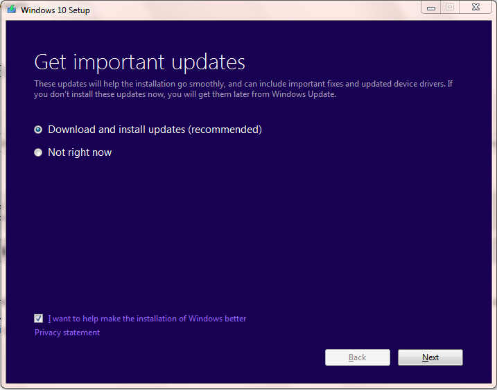

    so when i pass this step.
    Setup has encountered a critical error Sorry, we're having trouble determining if your PC... 280fb1e3-311d-4029-a658-921f479a8849.png

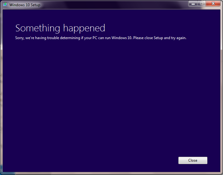

    and click Next it says "Checking Your PC" and then in few seconds i got this error.
    Setup has encountered a critical error Sorry, we're having trouble determining if your PC... 3fef9734-0817-4ca1-b5f5-91c8b9859ce6.png
    "sorry we're having trouble determining if your pc can run windows 10. Please close setup and try again."

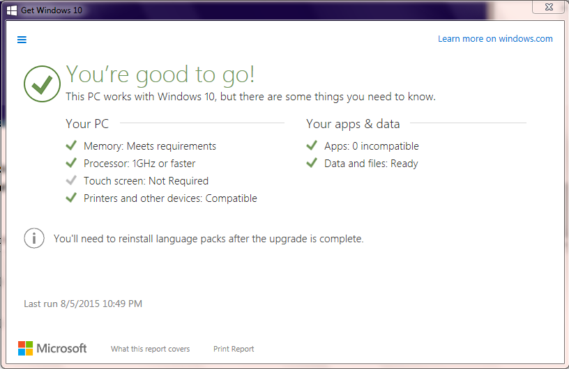

    i check my PC and it is good to go for windows 10 upgrade.
    Setup has encountered a critical error Sorry, we're having trouble determining if your PC... 0179573d-6c04-4c7a-b95d-aee18eff9e42.png
    BUT having that error "sorry we're having trouble determining if your pc can run windows 10. Please close setup and try again."
    can anyone help me out please?
