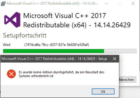

    I can't repair the VC installation, whenever I run VC_redist.x64.exe to repair it, I get a popup message saying I need to restart:
    Repair/uninstall of Visual C++ 2017 x64 14.14.26429.4 not possible 75e544c8-39a3-47f1-a8b4-04a51186af85?upload=true.png

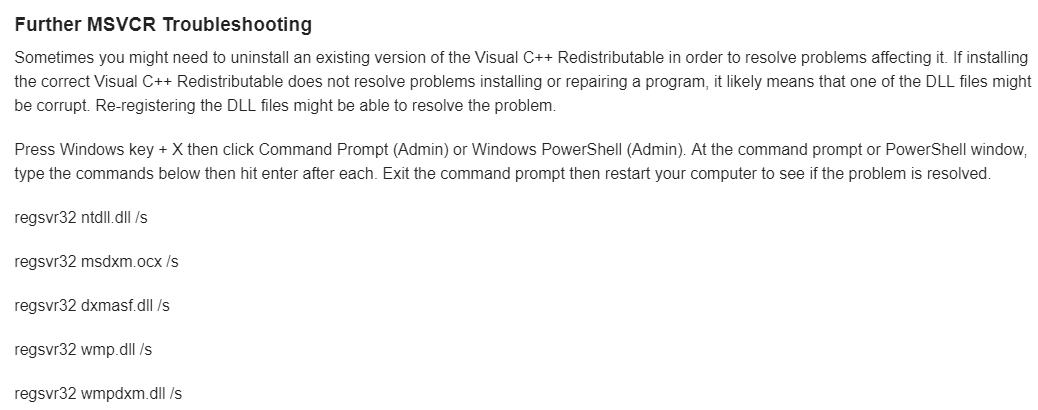

    Following dll where registered again:
    Repair/uninstall of Visual C++ 2017 x64 14.14.26429.4 not possible ad9d092b-1d0b-4680-bd43-2181e3f22de8?upload=true.png

    When I run VC_redist.x64.exe as Administrator and hit "uninstall" I get the message "uninstallation successful" and I can hit OK. If I check installations, it's still installed, after reboot, still installed, running the installer again let me only chose "repair" or "uninstall" again. Repair leads to "reboot required".
