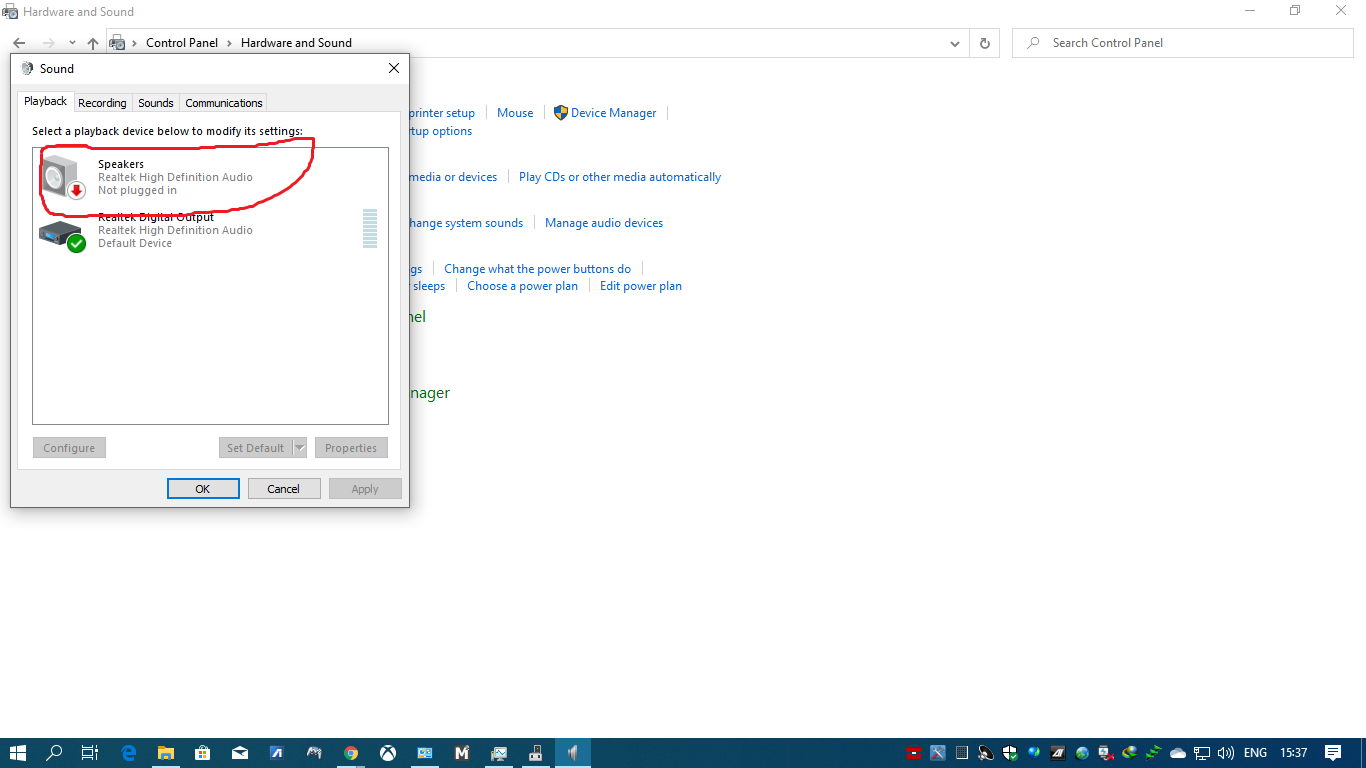

  1. Realtek HD audio speakers "Not plugged in"
    please help me Realtek HD audio speakers "Not plugged in" 00c8341e-7e13-4fdb-bf88-dadb7fd0540e?upload=true.png
    WildanAmidjaya, Apr 15, 2020

  4. Realtek HD audio speakers "Not plugged in"
    Explanation - About 2 days ago my new mini its chassis came in "NCASE M1". I put my computer together and everything seemed to be running perfectly. When I signed in for the first time the next
    day, the sound icon in the bottom right corner of the taskbar. There was a little red x. Usually, this just means that I don't have a default playback device selected and I could fix it very easily. But I was prompted with troubleshooting
    of all my playback devices. Told my "Realtek HD Audio 2nd output is not plugged in. I hover over the sound icon on the taskbar and it says "No speakers or headphones are plugged in". Although I have like 2 headphones plugged in and two front speakers that
    should be working. Below is a list of things I've already started to hopefully resolve the problem. none of them below have worked for me.
    Things I've Already Tried - (NONE OF THESE HAVE WORKED)
    • Reinstalling Realtek Driver
    • Ran the windows sound troubleshooter
    • Attempted a system reset (didn't work came up with error
      "Windows has a problem resetting your computer: no changes has been made".
    • Uninstalled soundcard driver and restarted.
    At this point, I'm losing faith in everything. I've attempted what feels like every possible fix and still no good positive outcome. If anyone has any feedback on what my problem is I would be very thankful!
    TheRealCIVICAL, Apr 15, 2020
