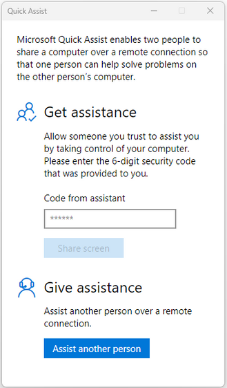

    Quick Assist now working after installing Windows 11 23H2. Error code 1002. 281652d1591196059t-quick-assist-not-working-1.png
