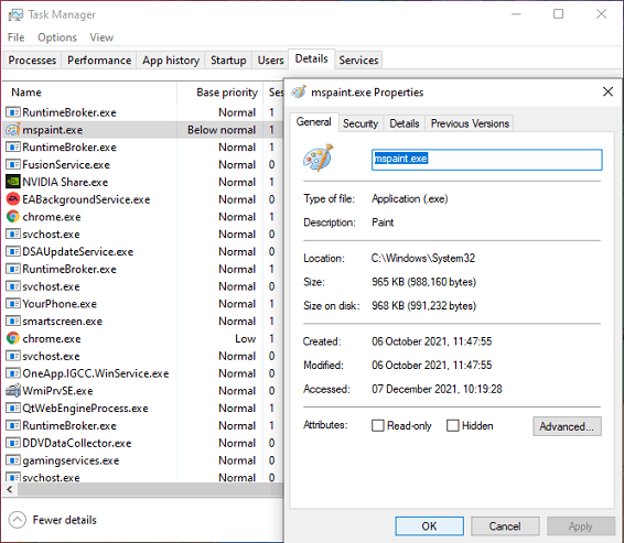

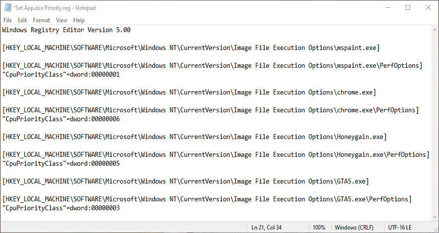

    1. Open Task Manager and click on the Details tab then select program.exe.
    Permanently setting Priority Processes Using Registry Editor does not work for "NVIDIA... d6bad212-b114-467a-bacd-899ffe5d1b3f?upload=true.png

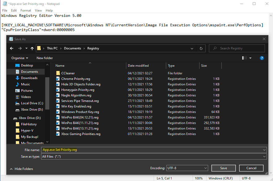

    2. Open a new Text Document and copy & paste this registry command.
    Windows Registry Editor Version 5.00
    [HKEY_LOCAL_MACHINE\SOFTWARE\Microsoft\Windows NT\CurrentVersion\Image File Execution Options\PROGRAM.EXE]
    [HKEY_LOCAL_MACHINE\SOFTWARE\Microsoft\Windows NT\CurrentVersion\Image File Execution Options\PROGRAM.EXE\PerfOptions]
    "CpuPriorityClass"=dwordPermanently setting Priority Processes Using Registry Editor does not work for "NVIDIA... :pRIORITY
    3. You need to replace the PROGRAM.EXE to your application and change the PRIORITY to a hex value.
    PROGRAM.EXE:
    mspaint.exe
    PRIORITY:
    High: 00000003
    Above Normal: 00000006
    Normal: 00000002
    Below Normal: 00000005
    Low: 00000001
    4. Save the text document as a .reg extension file.
    Permanently setting Priority Processes Using Registry Editor does not work for "NVIDIA... ffc2bfc0-6c95-4854-ac9a-ec7f047d0cd0?upload=true.png

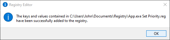

    5. Double-click on the reg file and click Yes, then click Ok.
    Permanently setting Priority Processes Using Registry Editor does not work for "NVIDIA... 5c823b0c-421d-43c4-a73b-23c0f3e3dac0?upload=true.png

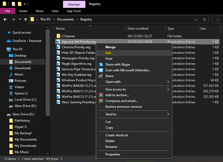

    6. Right-click on the registry file to modify, and select Edit.
    Permanently setting Priority Processes Using Registry Editor does not work for "NVIDIA... 63b5ada5-8981-41c7-aa96-f4ce74d90498?upload=true.png

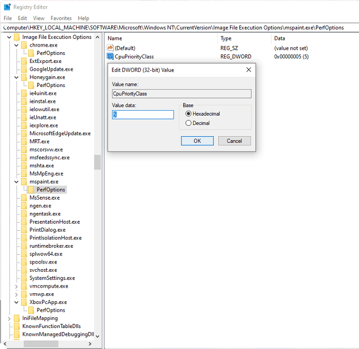

    7. You can add more applications below the next registry command.
    Permanently setting Priority Processes Using Registry Editor does not work for "NVIDIA... f1b90ee3-9c8b-47e9-8d64-2068a3576f45?upload=true.png

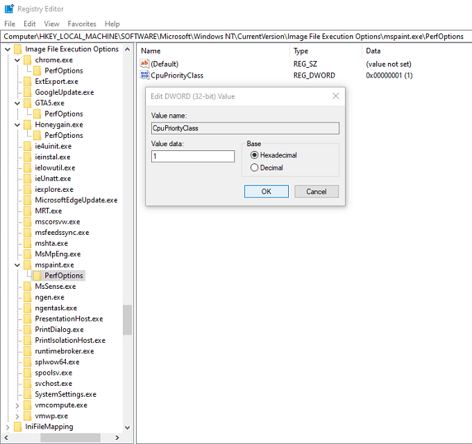

    8. Now, if you wish to change the application priority or delete the exe reg folder and revert back to default, then need to restart Windows.
    Permanently setting Priority Processes Using Registry Editor does not work for "NVIDIA... 2115f818-d2f3-429b-94ce-db02c6500811?upload=true.png

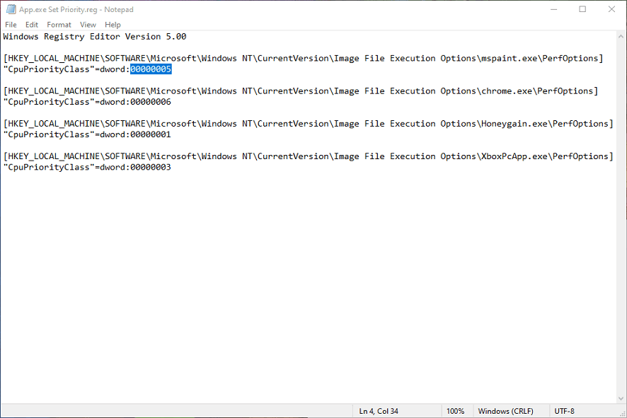

    3. You need to change the PROGRAM.EXE to application and change the PRIORITY to a hex value.
    Hex Priority:
    High: 00000003
    Normal: 00000002
    Low: 00000001

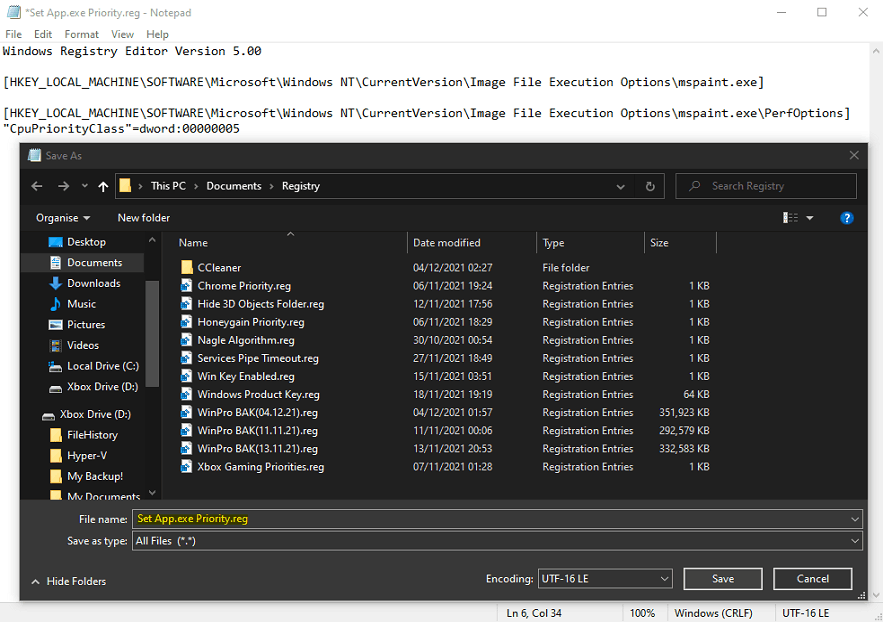

    Permanently setting Priority Processes Using Registry Editor does not work for "NVIDIA... 01543534-aa6e-4b8f-b055-8a8d7f18392f?upload=true.png
    5. Double-click on the reg file and click Yes then click Ok.
