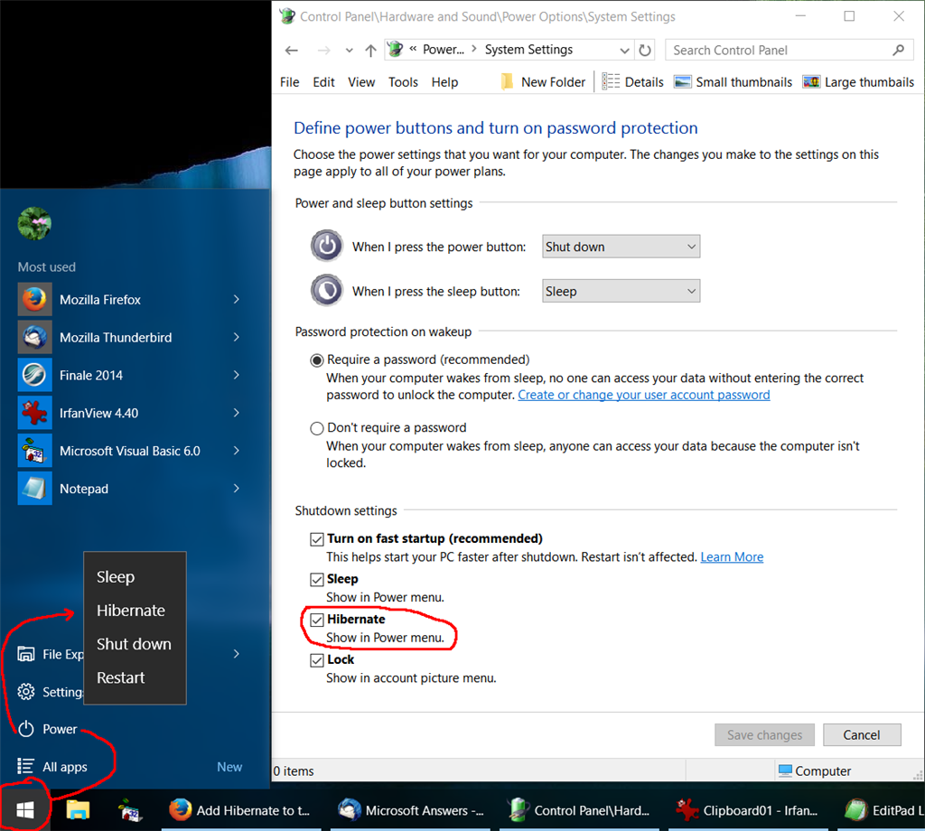

    Check and make sure that your graphics card/device is using an OEM driver. Drivers for Windows 8/8.1 may work if you cannot find a driver for Windows 10. If it's using a Microsoft Basic Display driver (or something like that), sleep will not work.
    Secondly, Windows 10 fully supports hibernating, and hibernation sometimes works even if sleep will not. Just in case, it may be worth following the steps below to enable hibernation:
    • Right-click the Start button and click Command Prompt (Admin).
    • Type the following command and press [Enter]: powercfg -h on
    • Close the command window.
    • Right-click the Start button and click Power Options.
    • Click Choose what the power buttons do.
    • Click Change settings that are currently unavailable.
    • Scroll down (if needed), tick Hibernate, and click [Save changes].
    • Click Start -> Power -> Hibernate to try out the new feature.
    If the hibernate option is missing in steps 7 and/or 8, your laptop probably has a driver issue preventing it from using low power states.
