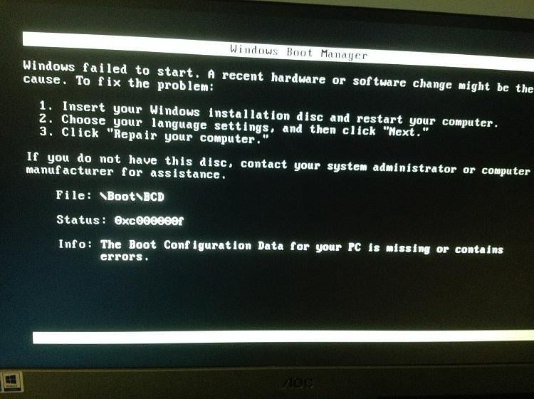

  4. PC is trying to boot from newly installed SSD.
    can't get PC to boot from newly installed SSD
    Installed SSD and copied boot HDD image with ' true. image ' which seemed to work perfectly...
    Tried to boot from SSD by pressing F12 during boot up but got this message
    PC is trying to boot from newly installed SSD. 74842d1485965779t-cant-get-pc-boot-newly-installed-ssd-image.jpg
    tried going into the bios to choose the SSD but wasn't an option that I could see, when I boot with the original HDD it is now labelled 'G' and the SSD as 'C' if that matters ???
    Installed an SSD on my laptop, but with only one ' drive' I guess it was easier..
    thanks
    reddwarf4ever, Oct 31, 2024
