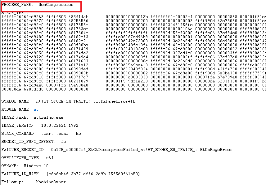

    Based on the provided BSOD (Blue Screen of Death) report, the error code is FAULTY_HARDWARE_CORRUPTED_PAGE (Bugcheck 12b). This indicates that a single bit error was found in a page, suggesting a hardware memory error. See more explanation below:
    Bug Check 0x12B FAULTY_HARDWARE_CORRUPTED_PAGE - Windows drivers | Microsoft Learn
    The specific information from the dump file includes:
    • Arg1: ffffffffc00002c4, virtual address mapping the corrupted page
    • Arg2: 0000000000000868, physical page number
    • Arg3: 000001f8c45fe280, zero
    • Arg4: ffffaa0206ada000, zero
    The stack trace points to an issue with memory compression (PROCESS_NAME: MemCompression). It seems that there was an error while decompressing data, which led to the memory corruption. As shown in the pictures:
    PC hardware probably faulty causing bsod, need help to troobleshoot QCSKUWWLQG0GSXX%2fh2nD8nYY5RJNQFmmZUKSJhYHRzRteP4wyxNQ3kkRd%2f3qqxlpcaiLCQTGgrwe9eVkjTdCbSn5c%3d.png
    Possible reasons for this issue could be faulty RAM, an issue with the memory controller, or other hardware-related problems.
