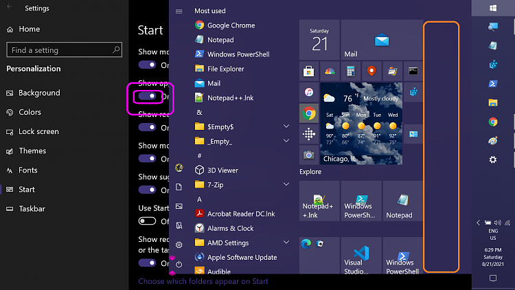

    Odd Start Menu Behaviour
    Settings > Personalization > Start > Show more tiles on Start
    Odd slow-down behaviour after disconnecting power-charger to laptop. 344064d1629589190t-odd-start-menu-behaviour-screenshot-1073-.png
    • Off: Three columns of tiles:

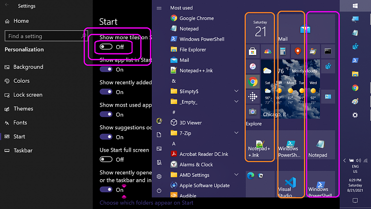

      Odd slow-down behaviour after disconnecting power-charger to laptop. 344066d1629589201t-odd-start-menu-behaviour-screenshot-1071-.png
    • On: Four columns of tiles:

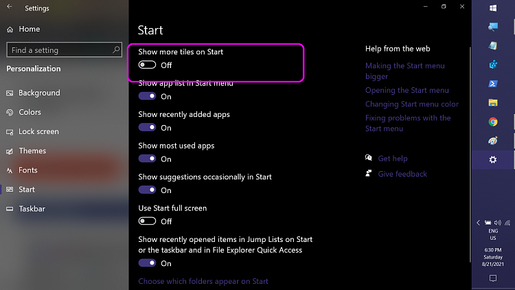

      Odd slow-down behaviour after disconnecting power-charger to laptop. 344067d1629589573t-odd-start-menu-behaviour-screenshot-1072-.png
