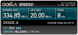

    I need some suggestion on good DNS servers that I can connect to and not find myself with problems all the time, I've used FF, Chrome, Edge and Comodo Dragon but all seem to have issues especially with the DNS that I'm connected to.
    I'm currently using the Google one, but if you know any good ones then please suggest it!
    I've also read about having my own DNS server but that just seems as a big crambamboli.
    And if you think that it's my internet that is having a stroke or something:
    My PC can’t connect to DNS server 79791d1485966997t-dns-server-suggestions-5325417954.png
    Cheers, Boris My PC can’t connect to DNS server :)
