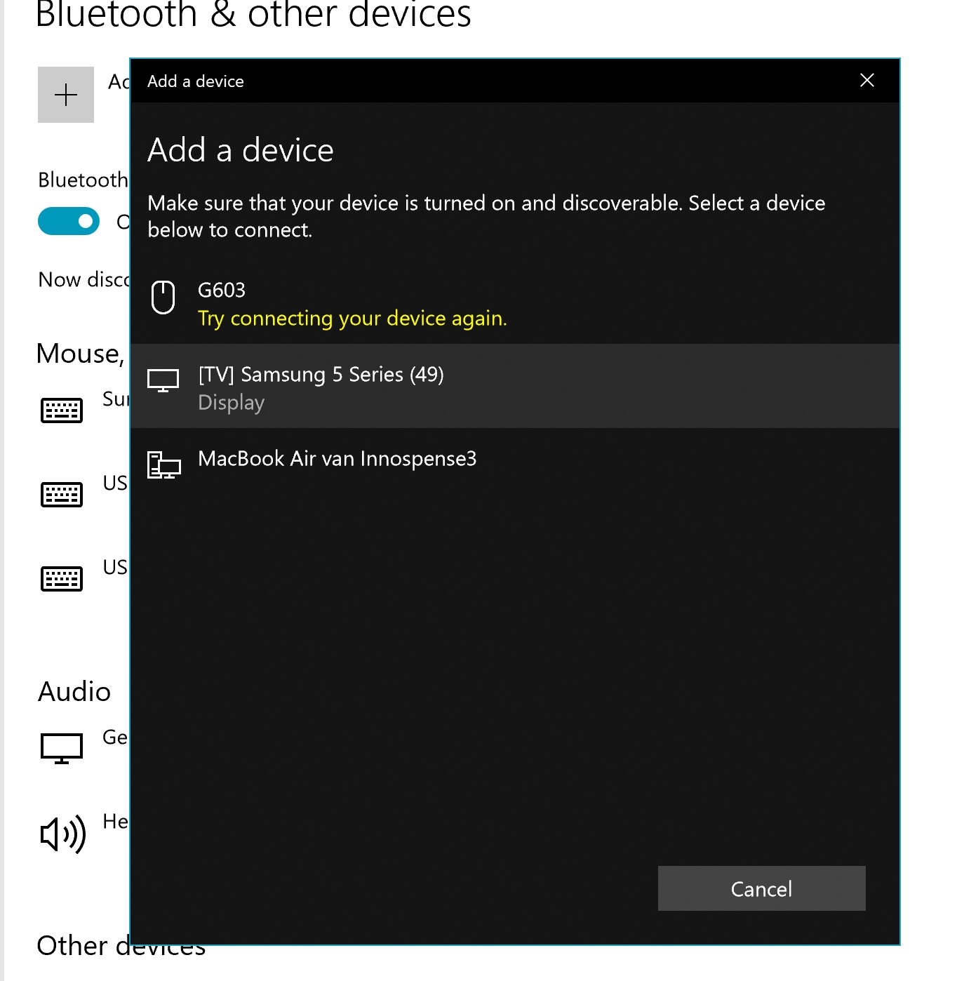

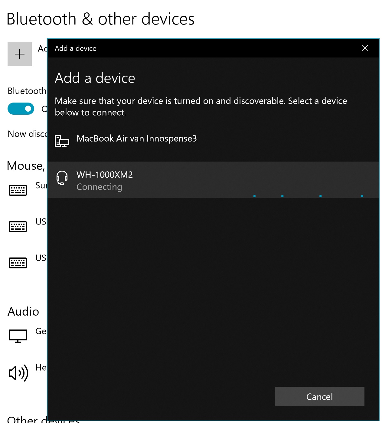

    Show hidden devices and to uninstall the G603 driver here. I did that, but from then on I could never reconnect to the G603 ever again. After a reboot I did see the G603 come up and tried connecting to it [1], but I could never connect to it again [2] rendering
    the message "Couldn't connect. Try connecting device again".

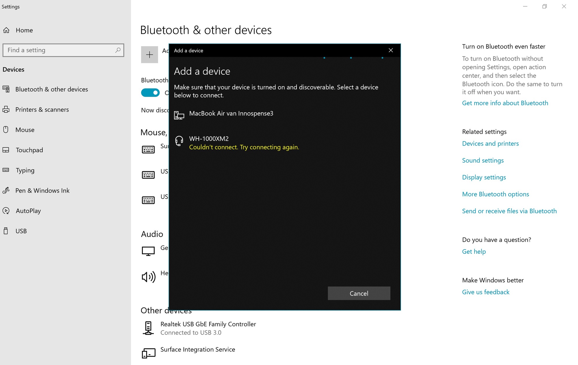

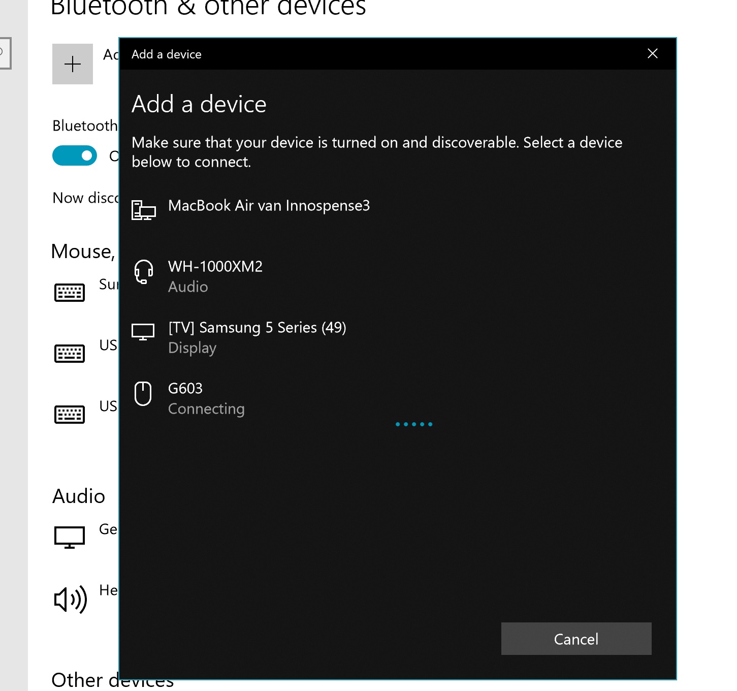

    Then I got to think about if it is only the mouse or if it is the complete Bluetooth driver. In the "Bluetooth & other devices" I clicked on the option to forget the Sony WH-1000XM2. Then when I wanted to connect them again to my computer through Bluetooth
    [3] and I got the same message as with the G603 Bluetooth mouse [4]. Some 'fixes' I came along again stated to uninstall the driver but now for the WH-1000XM2. However, the "Bluetooth" section in Device Manager does not seem to work the same as with the other

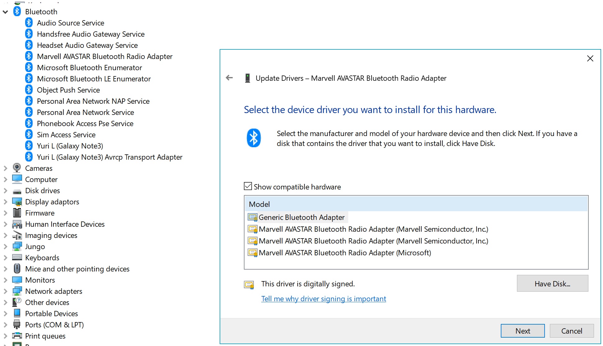

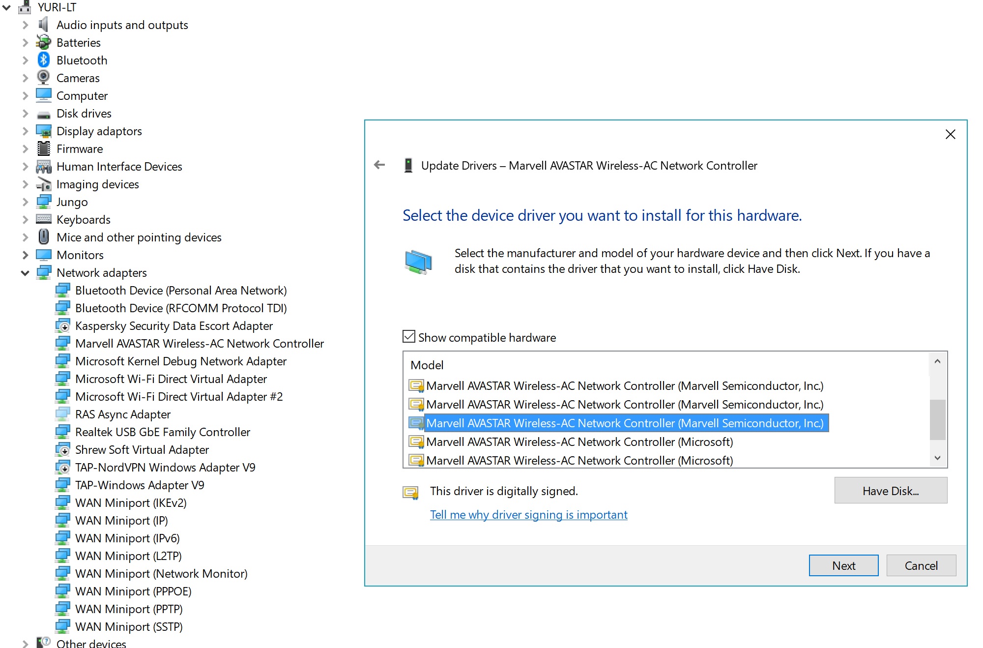

    In the device manager I went to look for other drivers for the Bluetooth Radio Adapter. However, I saw a lot of duplicate drivers. Under "Bluetooth" I see one single 'Generic Bluetooth Adapter', two 'Marvell AVASTAR Bluetooth Radio Adapter (Marvell Semiconductor,
    Inc.)' and one 'Marvell AVASTAR Bluetooth Radio Adapter (Microsoft)' [5]. Under "Network adapters" I see 6 'Marvell AVASTAR Wireless-AC Network Controller (Marvell Semiconductor, Inc.)' and two 'Marvell AVASTAR Wireless-AC Network Controller (Microsoft)' [6].

    • Uninstalling under "Bluetooth" in Device Manager the Marvell AVASTAR Radio Adapter and reboot machine. Doing this actually creates all these duplicate drivers [5,6].
    Marvell AVASTAR Bluetooth broken functionality 92fb405b-4e8b-4fb4-baf8-60c986d66a6b?upload=true.jpg
    Marvell AVASTAR Bluetooth broken functionality 29bd158f-bb91-4fca-bd4e-190d4e5de653?upload=true.jpg
    Marvell AVASTAR Bluetooth broken functionality d2ed4c9e-a549-4c65-8a40-600921268b5d?upload=true.jpg
    Marvell AVASTAR Bluetooth broken functionality c7e20e87-589b-4832-a7ef-ae2c639b313c?upload=true.jpg
    Marvell AVASTAR Bluetooth broken functionality 219a7242-1d3e-4a24-9894-9da9341e5b03?upload=true.jpg
