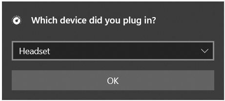

  4. I keep getting “Which device did you plug in?”notification without me plugging anything.
    Disabling "Which device did you plug in?" notification
    I have been looking for a solution for a while, but I can't find one that works for me. I have been trying to disable this notification:
    This pops up whenever I plug in headphones or earbuds, and neither will start producing sound until I click 'OK'.
    I keep getting “Which device did you plug in?”notification without me plugging anything. cde00984-d2fa-4562-95c3-8e0ae70290f0?upload=true.png
    The RealTek console has absolutely no controls for this notification or any jack detection check boxes, There is no RealTek audio device in Control Panel, Waves MaxxAudio does not have any controls for this, and I can't find anything about it in the sound
    device manager. The bios has no settings pertaining to audio. Additionally, because I have to push 'OK' every time I plug something in, I can't simply stop the notification from popping up at all. I need to make my PC remember my choice, default to the device
    I just plugged in over the laptop speakers, and never ask again.
    This problem is occurring on a fairly new Acer Nitro 5 laptop. The only modification I have made is installing an extra HDD. The problem existed even before I made that modification, though, so I don't think that has anything to do with it. The port in question
    is the only audio jack on the laptop.
    Isaac Schalk, Mar 27, 2021
