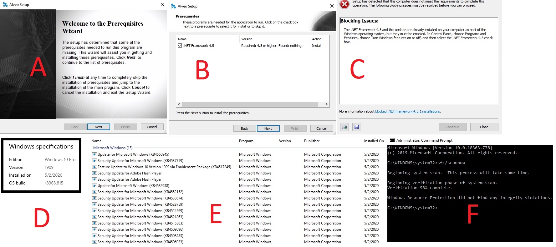

    I get this wizard A, B, C every time I try to install some programs. Even after I reset the system 2 days ago May, 2, 2020
    My system is up to date D, E
    I have tried repair tools, they didn't work NET Framework Repair Tool didn't work
    I tried sfc/scannow and everything is fine F

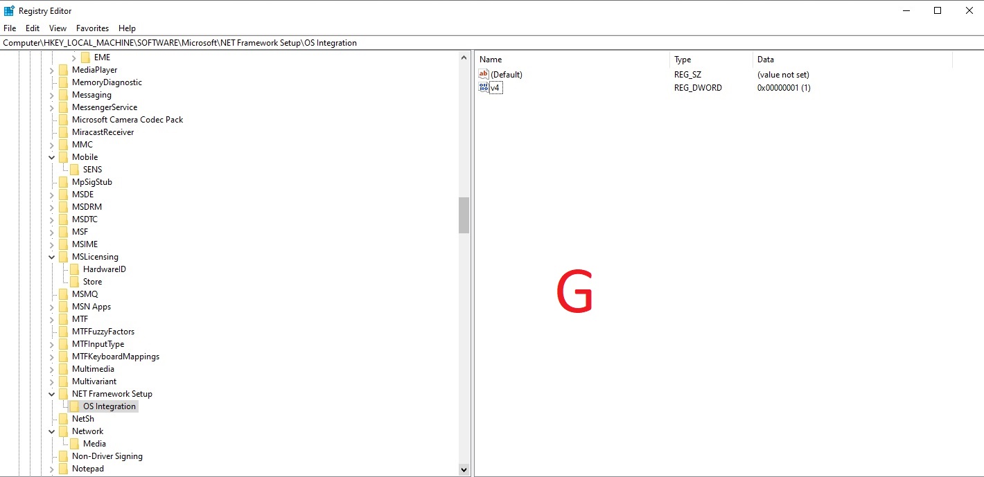

    Image G Computer\HKEY_LOCAL_MACHINE\SOFTWARE\Microsoft\NET Framework Setup\OS Integration .....................Only shows v4.

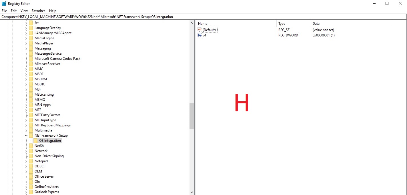

    Image H Computer\HKEY_LOCAL_MACHINE\SOFTWARE\WOW6432Node\Microsoft\NET Framework Setup\OS Integration ...........Only shows v4.

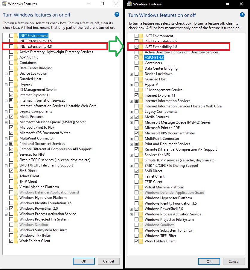

    In windows features on or off. If I check ASP.NET 4.8 or/and .NET Extensibility 4.8, I click OK then I get the message "Windows completed the requested changes". After this, I restarted the system and I try to install the program, but It shows the wizard A again and for any reason, the boxes are unchecked
    Should I wait for a new Windows update?
