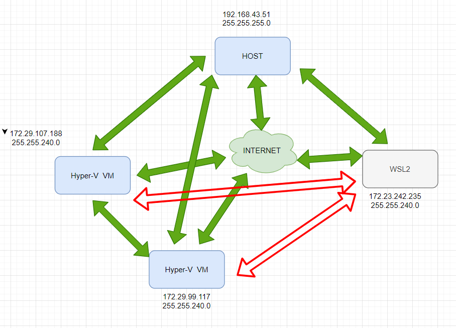

    I have this situation:
    Hyper-V and WSL2 networks do not communicate ee6b14e8-ba0a-47ab-ae53-a32d25db34a4?upload=true.png
    [COLOR=rgba36, 39, 41, 1]The Host is Windows 10 Pro ver. 20H2[/COLOR]
    [COLOR=rgba36, 39, 41, 1]The Host, the Hyper-V VMs and WSL2 all have Internet access; they all can communicate each other, except wsl2 towards the VMs and vice versa the red arrows.[/COLOR]
    [COLOR=rgba36, 39, 41, 1]The Hyper-V VMs use the "Default Switch" vNet: 172.29.96.1, netmask: 255.255.240.0, conn type Internal[/COLOR]
    [COLOR=rgba36, 39, 41, 1]WSL2 uses "WSL" vNet: 172.23.240.1, netmask: 255.255.240.0, conn type: Internal[/COLOR]
    [COLOR=rgba36, 39, 41, 1]There is a third vNet, named "nat", I can see using "ipconfig" but that is not listed in Hyper-V virtual switch manager: 172.25.128.1, netmask 255.255.240.0, conn type: ?[/COLOR]
    [COLOR=rgba36, 39, 41, 1]Can anyone help me? Thanks[/COLOR]
