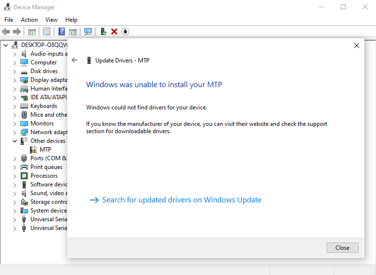

  1. Having problem to update MTP Driver
    Having problem to update MTP Driver 59079915-61be-4552-9a28-2c2fe2cce6a4?upload=true.png
    As you can see suddenly I having problem to update the MTP driver, it's keep showing me this message. I tried all possible solution from internet but I didn't find the right one. Please help me with the solution.
    MdHasanh29, Dec 27, 2020
  2. Ch863 Win User
    MTP Driver Error when trying to update or reinstall (Windows 10)
    I had the same issue with Windows 10 1607, Windows correctly installed the MTP driver for my phone the first time I plugged it in, then failed to recognize the phone the next times I plugged it in using the MTP protocol. Seems it's a bug with Windows 10,
    if you google "Windows 10" MTP android limiting the search to the past month you'll find a bunch of people with the same issue.
    Try to manually install the MTP USB Device driver see if that fixes the issue for you too.
    Right click on your phone (should be in Portable Devices) in the Device manager, on the driver tab click "Update Driver..." On the "update Driver Software" window select "Browse my computer for driver software" on the next windows select "Let me pick from
    a list of device drivers on my computer" then in the list of compatible hardware devices, select "MTP USB Device" click next and your phone should be working again.
    If you don't see MTP USB device in the list of compatible hardware, manually install the MTP USB device using the Add legacy hardware wizard. (Add legacy hardware -> Install the hardware that I manually select from the list (Advanced) -> in the list select
    "Portable Device" -> in the next list pick "MTP USB Device" then install it. Once it's installed redo the steps I gave you in the previous paragraph, the "MTP USB Device" should be showing now in the list of compatible hardware.
    Cheers~
    Ch863, Dec 27, 2020
  3. Roohi_Taj Win User
    MTP not working
    Hi Neeraj Chimwal,
    Could you please answer the below questions:
    1. What is the version of Windows you are using?
    2. Did you make any changes to the computer prior to this issue?
    Media Transfer Protocol(MTP) allows media files to be transferred
    automatically to and from portable devices. Devices using MTP have a USB connection that allows users to connect the device directly to a computer. To transfer the files we require a specific driver, if the driver is corrupted, we come across
    these issues.
    I suggest you to follow the troubleshooting steps mentioned below:
    Method 1: Install Media feature pack.
    I would suggest you to install
    Media Feature Pack.
    Select the edition as 1803 and follow the on screen instructions. Once the installation is done, go back to
    C:\Windows\INF folder and search for "wpdmtp.inf" file.
    Method 2:
    Install the MTP driver.
    Step 1:
    1. Press Windows and
      R key together on your Keyboard.
    2. Type devmgmt.msc and hit enter.
    3. Select the driver, right click and select update driver.
    4. Click on “Browse my computer for driver software”.
    5. Now select "Let me pick from a list of device drivers on my computer".
    6. You will have a list, select "MTP USB Device" and click on next.
    Step 2: If MTP USB device in not listed in compatible hardware, then manually install the MTP USB driver.
    1. Click on Action > select
      Add legacy hardware.
    2. Select install the hardware that I manually select from the list (Advanced).
    3. Select "Portable Device" > Now, select
      MTP USB device and start the installation.
    4. Now MTP device will be visible under compatible hardware mentioned in the
      step 1.
    Method 3: Modify registry.
    Note: Serious problems might occur if you modify the registry incorrectly. Therefore, make sure that you follow these steps carefully. For added protection, back up the registry
    before you modify it. Then, you can restore the registry if a problem occurs. To backup and restore registry key, refer Microsoft article on
    How to back up and restore the registry
    in Windows
    2. Type regedit and hit enter.
    3. Navigate to the following key:
      HKEY_LOCAL_MACHINE\SYSTEM\CurrentControlSet\Control\Class
    4. Click Edit menu on top and select
      Find.
    5. Type Portable Devices into the box and click
      Find Next.
    6. Check for UpperFilters from the right pane and right click on it > Select
      Delete.
    7. Close the registry and check if MTP issue is fixed.
    Having problem to update MTP Driver 47ce4291-aeed-4260-bb91-eede36dc7714?upload=true.png
    Hope it helps.
    Let us know if you got the help you needed by clicking ‘Yes’ or ‘No’.
    Roohi Taj S
    Roohi_Taj, Dec 27, 2020
