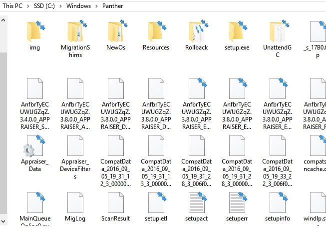

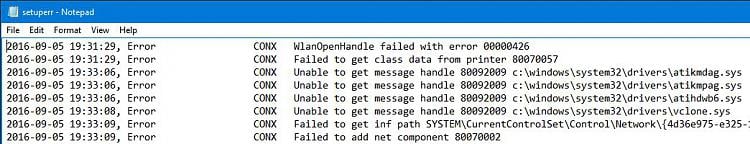

  3. CmmTch Win User
    Anniversary update fails with error 0xC1900101 - 0x20017
    I followed the directions C: > Windows > Panther and found the two text files, setuperr dated 9-15-2016 on a failed attempt
    Failed update Windows 11 24H2 Install error - 0xc1900101 - 0x20017 103331d1485972304t-anniversary-update-fails-error-0xc1900101-0x20017-setuperr-c-windows-panther.jpg
    Setuperr below, appears ATI drivers are listed at the top. Maybe this is what the troubleshooting page refers to, I'm not uninstalling them. W10 should replace them with MS working drivers if the W10 AU can't handle them. It could be the problem, but it wasn't a problem the first RTM or the November update.
    Since the AU is now considered the "paid" version for those that didn't take advantage of the free upgrade W10 may be picky about an install. I'm not doing a clean install, if W10 is now the new "running as a service OS" it should be able to update itself without issue. Meaning any computer running any version of W10 without problems should upgrade without problems.
    Failed update Windows 11 24H2 Install error - 0xc1900101 - 0x20017 972304t-anniversary-update-fails-error-0xc1900101-0x20017-ati-drivers-setuperr-au-failed-attempt.jpg
