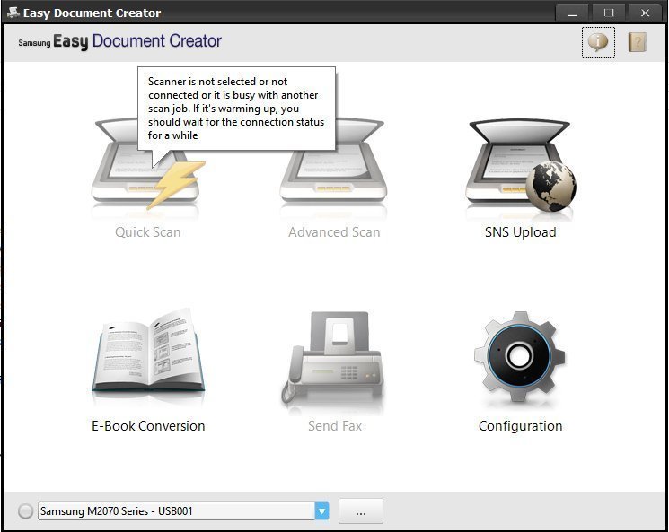

  1. MarkS-H Win User
    Device USBPRINT\SamsungM2070_Series\9&1636df7b&0&USB001 requires further installation.
    On May 20 2018 I posted a thread to say that my Samsung M2070 was reporting an error everytime I tried to scan while using the Samsung Easy Document Creator that was discussed here:
    Samsung M2070 Easy Document Creator Error
    **** I cannot add to the thread as it has been locked ****
    Device USBPRINT\SamsungM2070_Series&1636df7b&0&USB001 requires further installation. a57442b0-a370-4a93-87f1-780b89d73279?upload=true.jpg
    Device USBPRINT\SamsungM2070_Series&1636df7b&0&USB001 requires further installation. a60d0513-33ce-4f51-86f1-ad62b22b5a65?upload=true.jpg
    15 September 2018
    Anyway, I looked around today on the HP website support pages and found this:
    HP website Samsung M2070 drivers
    I looked under software and downloaded the Samsung Easy Document Creator V2.02.53
    I installed this software but which after installation my PC required a reboot which I did.
    I opened the newly installed software and at first it did not find my Samsung M2070 printer but clicking the magnifying glass my PC found the printer.
    I am now glad to say that the new software appears to be working fine.
    Hope this thread help others with the same problem.
    PS. I am now also using Windows 10 Pro Version 1803 OS Build 17137.285
    MarkS-H, Sep 15, 2018

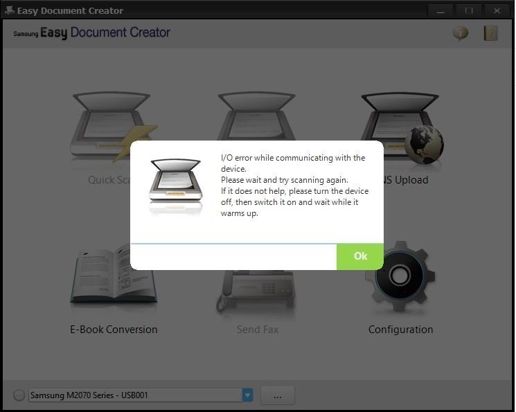

  2. MarkS-H Win User
    Model: Samsung Xpress SL-M2070 Laser Multifunction Printer
    19 May 2018 - Got this error after updating Windows 10 Pro to Version 1803 OS Build 17134.48 the other day
    • Only the scanner function does not work - printing is working fine
    Before the Windows 10 update the printing and scanning function worked fine without any problems.
    Now...normal printing works without problem.
    I am getting this error when trying to scan something and using the Samsung Easy Document Creator
    The scanner function is greyed out and it reports an I/O error while communicating with the device. Please wait and scan again. - See image below.
    Tried different USB cables - this does not work.
    Tried turning the printer off and then back on - this does not work.
    Tried uninstalling and reinstalling the drivers and software - this does not work.
    Downloaded the software - M2070_Series_WIN_Scanner_V3.31.38.04.exe and installing this - this does not work
    Downloaded the software - M2070_Series_WIN_EDC_V1.06.46_CDV1.25.exe and installing this - this does not work
