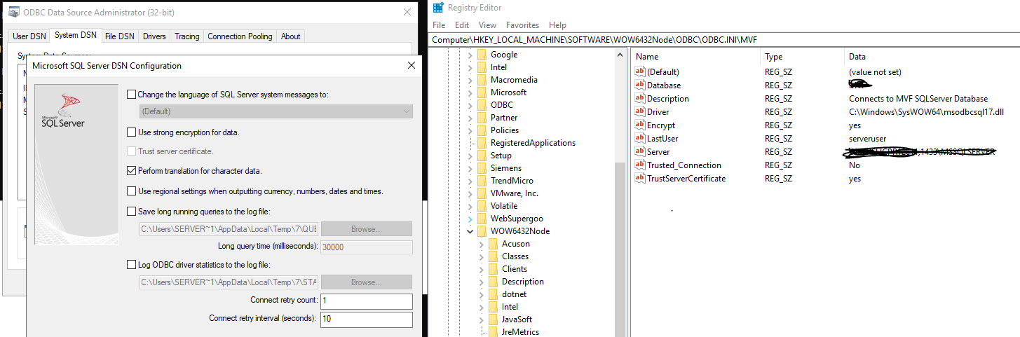

  2. ODBC Registry settings are not reflected in UI - ODBC Database administrator(32-bit)
    I am using Windows Server 2019 version 1809 OS Build 17763.1158. I want to enable encryption for ODBC DSN connection So I am calling this command "C:\Windows\SysWOW64\odbcconf.exe /A {CONFIGSYSDSN "ODBC Driver 17 for SQL Server" "DSN=MVF|Server=%SDX_DBSERVER%|Encrypt=yes|TrustServerCertificate=yes"}" from the script file (.bat file).
    Registry settings are updated properly under "Computer\HKEY_LOCAL_MACHINE\SOFTWARE\WOW6432Node\ODBC\ODBC.INI\MYDatasource" but when I launch ODBC Database administrator(32-bit) and selected my data source and clicked on configure -> Next -> Next->Next check
    Customized ODBC permission registry setting lost 435b4506-23ba-4496-8dc6-b7cfc30dc774?upload=true.png
    SARAVANA_007, Nov 28, 2024 at 3:30 AM
