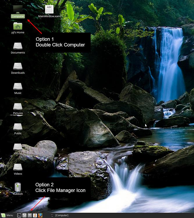

    I have made some screenshots of my Linux Mint 18.3 (installed & customised) setup as a guide.
    Running LM18.3 from a Live CD/DVD/USB will look different.
    Step 1
    Once the Desktop appears do one of these:
    1. Double click on the Computer icon
    2. Click the File Manager icon
    critical files are missing or damaged. please repair or reset your windows installation 1529815409t-windows10-update-damaged-something-attempting-repair-some-advise-adv-01-lm18-desktop.jpg

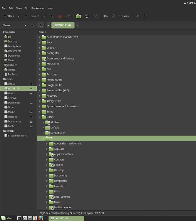

    Step 2
    Browse to the folder that has your files
    Even though it looks different to Windows it works basically the same
    The left pane lists the drives/partitions on your machine
    The right pane shows a directory/folder tree
    You can double click on a folder to view its contents (the tree structure will start at the folder you clicked)
    critical files are missing or damaged. please repair or reset your windows installation 529815409t-windows10-update-damaged-something-attempting-repair-some-advise-adv-02-browse-folder.png

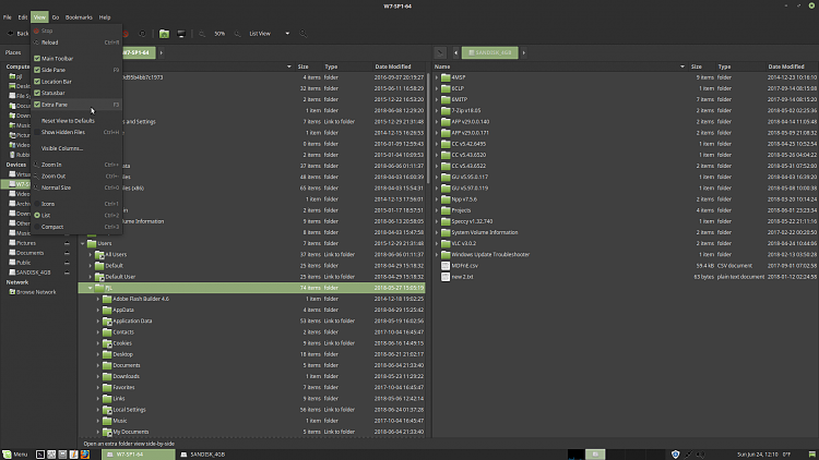

    Step 4
    You can open a twin pane view to make transferring the files easier.
    1. Go to the View menu and choose "Extra Pane"
    2. Click in the new pane (right pane) and then click on your USB drive (in the left pane which is showing the drives/partitions on your machine)
    3. Click in the pane (middle) that is showing the files/folders you want to save and select them
    critical files are missing or damaged. please repair or reset your windows installation 29815409t-windows10-update-damaged-something-attempting-repair-some-advise-adv-03-dual-pane-view.png
    Step 5
    The selection process is the same as Windows (i.e. you can use the Ctrl and Shift buttons to select multiple files).
    Once you have selected the files/folders you want to save, simply drag them, or "Copy& Paste" them, into the USB drive pane/window.
