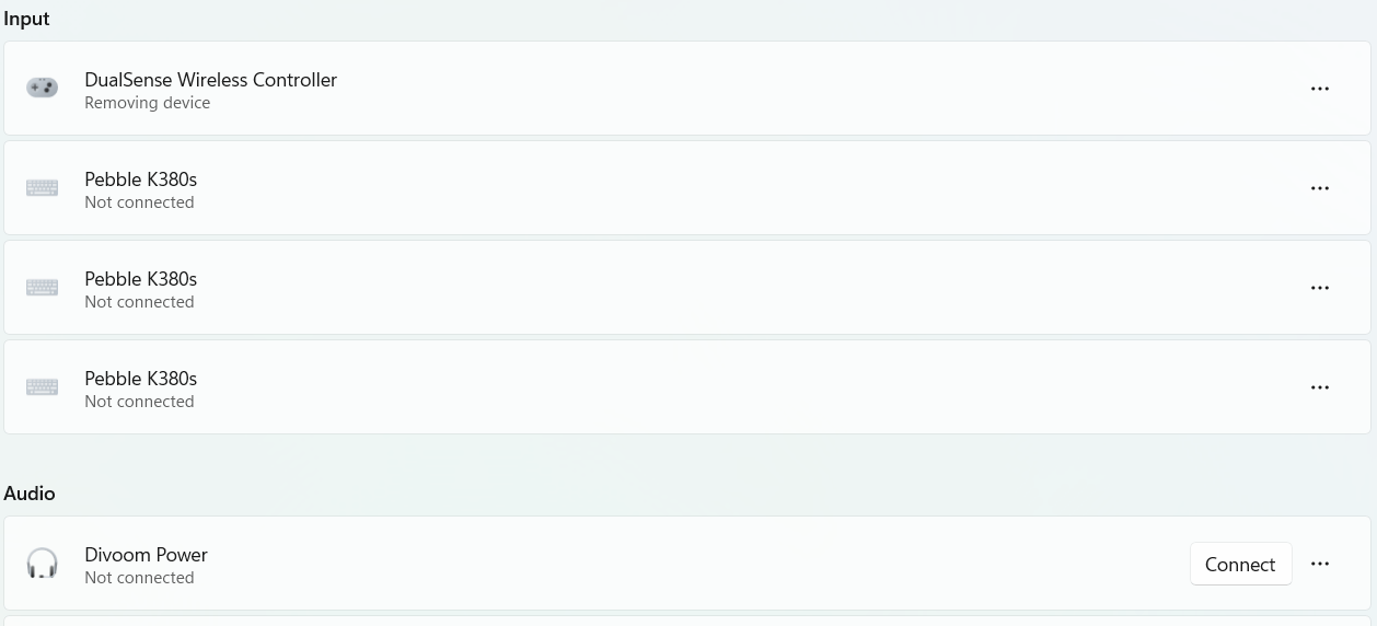

    "Couldn't connect" bluetooth errors with Dualsense controller wr61hRvjBJsdxALTsUDlMNY3wjZYiee9ZdXqOslAM%2FhuZvKk39zYvS2l%2BiWIk9mF0Jgme2n65rb5TK9ZpcqT0FPBU%3D.png
    Earlier its been removing device fine. But but out of the sudden it now failing to remove it.

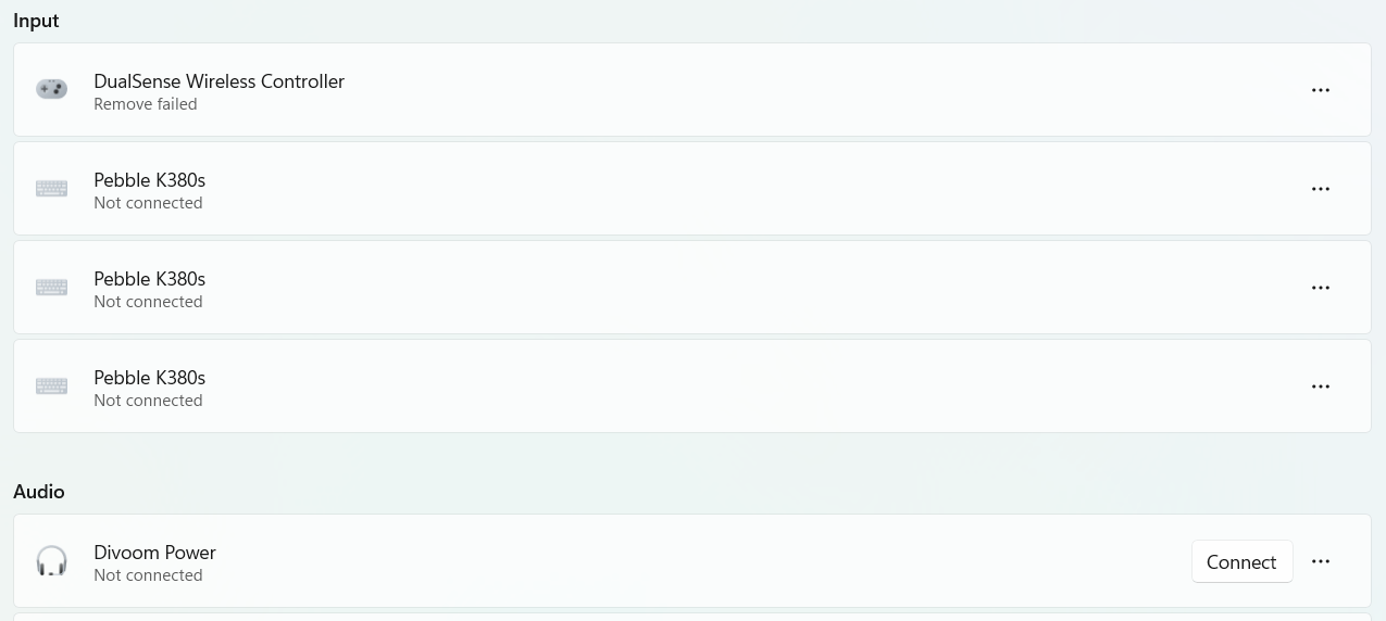

    "Couldn't connect" bluetooth errors with Dualsense controller bx92lzXSU5AS48%2FGqLl4HVsB%2B7vGch2V5n0wgh8n8yozTby5bBMUZYfR4sdq3UTkoXK40w0hRArEZ2b%2BPwRMqXA%3D.png
    I tried removing it from within the Control panel, Devices and printers - it does nothing after clicking Remove.
    I also deleted Dualsense from Device Manager - but it is still in the list of paired devices.
    I cannot pair it a second time - Windows Filters out devices that are already paired.
    It's a dead end. I cannot add it because it's already added and I cannot connect to it because there is no button to connect. I don't know how it was possible for Microsoft to make the system in such a way.
