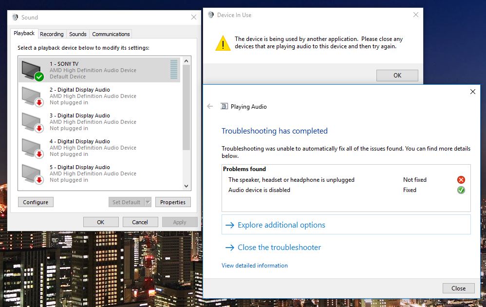

  3. Loss of audio on AMD HDMi audio interface after waking up from Sleep mode.(0x8889000F)
    I use a Sony TV with my PC, both Video and Audio signals go to it through Radeon R9 290X.
    Problem is, after my PC wakes up from a sleep mode I lose all audio playback on my TV until full system reboot.
    Troubleshooting doesn't help, it enables my on-board Realtek audio device, which doesn’t help. Sony TV is set as a default playback device, using "Test" function in Windows sound panel returns "device is in use" message.
    Programs such as Foobar2000 return "Unrecoverable playback error: Unknown error code (0x8889000F)" error message. Firefox works without any sound playback, everything is mute.
    I updated my drivers. Didn't help.
    Can't find an audio device 0x8889000F error 53d48bb6-7f7f-4582-82c8-6c9559c6214d.jpg
    MonoShadow, Nov 19, 2024
