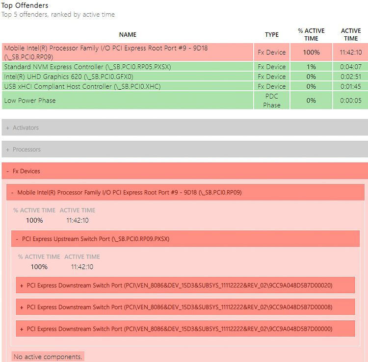

    I did this so that I could get as low power as possible, and I have no need for the computer to do anything while sleeping (which is why I prefer S3). I started with a fully charged computer and closed the lid. 11.75 hours later I opened the lid and the battery remaining was around 28%. So that is about 6.1% per hour discharge rate, which is quite excessive. I did powercfg /sleepstudy and it shows Mobile Intel(R) Processor Family I/O PCI Express Root Port #9 - 9D18 (\_SB.PCI0.RP09) 100% active during that time.
    Battery drained by Intel SOC Subsystems in Modern standby S0 330615d1619813506t-excessive-battery-drain-during-s0-sleep-modern-standby-msb.png
    I look in device manager and it reports the device is working properly, there are no conflicts, the version is 10.1.1.45 with a date of 7/18/1968 (odd date!), and provider is INTEL. When I look on the Lenovo support page for my computer, the chipset driver version is shown as 10.1.18228.8176 (12/25/2019) and if you look in the ReadMe it says 10.1.1.45 (1/30/2018) is two versions back. So I am not sure why the Lenovo auto updater isn't installing this. I am not even sure what a PCI Express Root Port #9 is, so I am really at a loss to determine why it won't go to a low power state.

    I updated the chipset driver to the version 10.1.18228.8176 found on the Lenovo website (Device Manager now shows it as 10.1.5.2 for the Mobile Intel(R) Processor Family I/O PCI Express Root Port #9 - 9D18 device). This time I started with the battery at 100% and closed the lid for 3 hours and the battery lost just over 30%. So that is over 10% per hour. The report has a 1 hour session where the computer was active (not in sleep or hibernate) and it only used 14% in an hour.
