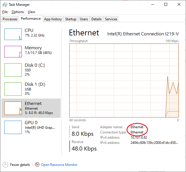

    Network Status window (Windows settings) disappeared always
    Yes, I renamed the adapter recently (Red circle ones) by command "Rename-NetAdapter -Name "Current Name" -NewName "New Name" in powershell", how can I do now? (I forgot the old name)
    Are you using VPN software or proxy services? No.
