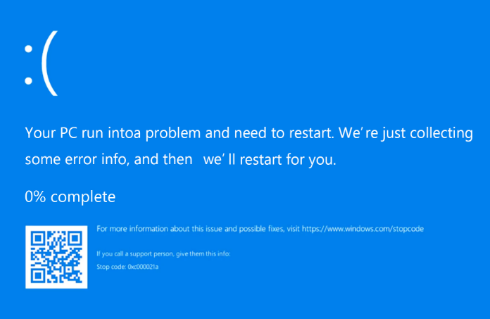

    hello everyone i have windows 10 computer but won't boot because 0xc000021a appear on screen. how can i fix it? sorry my bad english :
    i added screenshot.
    0xc000021a Error Windows boot dcdcead8-33d2-4746-bed7-45c98afcd376?upload=true.png

  2. Fix error 0xc000021a Windows 10
    I've faced this issue before. It's one of the blue screen of death errors. Im sharing 5 steps that will help you fix Error 0xc000021a
    One of the following step will sort out the problem:
    1. Repair corrupted system
    2. Boot window manually
    3. Resetting computer's BIOS
    4. DO SFC scan
    5. Troubleshoot to fix automatically

  3. Xylee Del Win User
    error 0xc000021a
    Corrupted system files may have caused the error 0xc000021a on your Windows 10. To correct this issue, we suggest that you perform the steps below:
    • Hold down the Shift key on your keyboard while you select
      Restart
      (Shift+Restart) from the power options for Windows.
    • Windows Recovery Environment window will come up.
    • On Choose an option screen, select Troubleshoot.
    • In the Troubleshoot screen, select Advanced Options.
    • Select Startup Repair, it will scan and repair your computer automatically.
    Xylee Del, Dec 30, 2019
  4. 0xc000021a Error Windows boot
    fix error 0xc000021a in windows 10
    Hi gilesrichards,
    The most common culprit of Error 0xc000021a is third-party application. To know more about the issue, please answer the following questions:
    1. What is the make and model of your device?
    2. Have you made any changes on your PC prior to the issue?
    3. When did you get this error?
    To isolate the issue, I suggest that you boot your PC on Safe Mode.
    We'll be waiting for your response.
